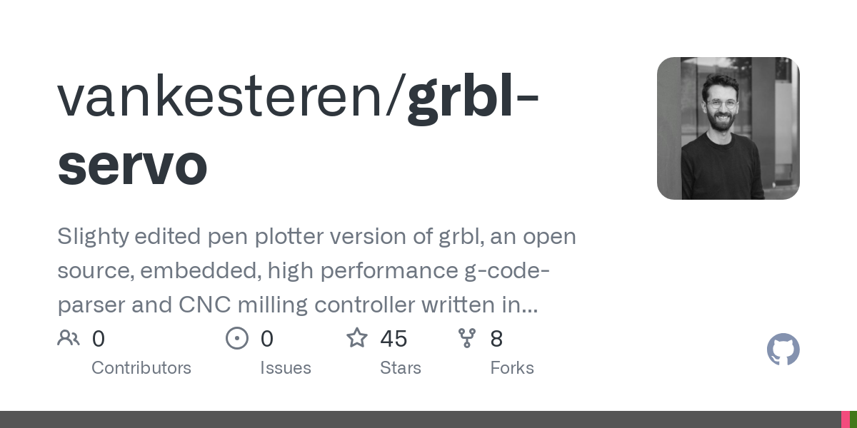

I found a grbl implementation already supporting a servo:
I haven’t the parts to test it but it might possibly work for homing with the right settings and gcode
If not, then it might be a good starting place to hack on grbl.
I will have a good look at that and see what I can understand.
There needs to be a way to do it as GRBL is a very popular system and it should have this feature available.
