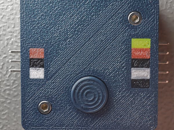

My 3D printer has a Z probe that is used to make sure the nozzle is the correct distance from the build plate. My suggestion is to look at a few machines and see if the probe makes sense. On my machine it looks like THIS

The 3d printing probes (BL-Touch, CR-Touch) use an retractable probe that triggers a switch on the extruder.
Of course because the laser module is on the Z axis that has to move to do the measurement. Only one calibration needed, that is distance from the laser module to the material surface.
Yes I was thinking about what sensors are used for 3D printers, some are using non contact types I am sure, but I need to find which they are.
This looks very promising. After looking at the website, I was unable to find any info on using it with a Uno board, so I will do a bit more research on that. It seems to be the best idea so far.
Yes that does look promising. Not enough info on their website as it is just a replacement part for their machines.
It's two pins -- one Servo.h-controlled pin to control the probe location, and one pin to read the probe pulse. From the BL touch page:
You'd send a myservo.write(10), then slowly move towards your bed while monitoring for a 10ms pulse on the sense pin and do a meservo.write(90) to retract.
Look at about 1:30 in their sales youtube video where they parallel it with with a servo.

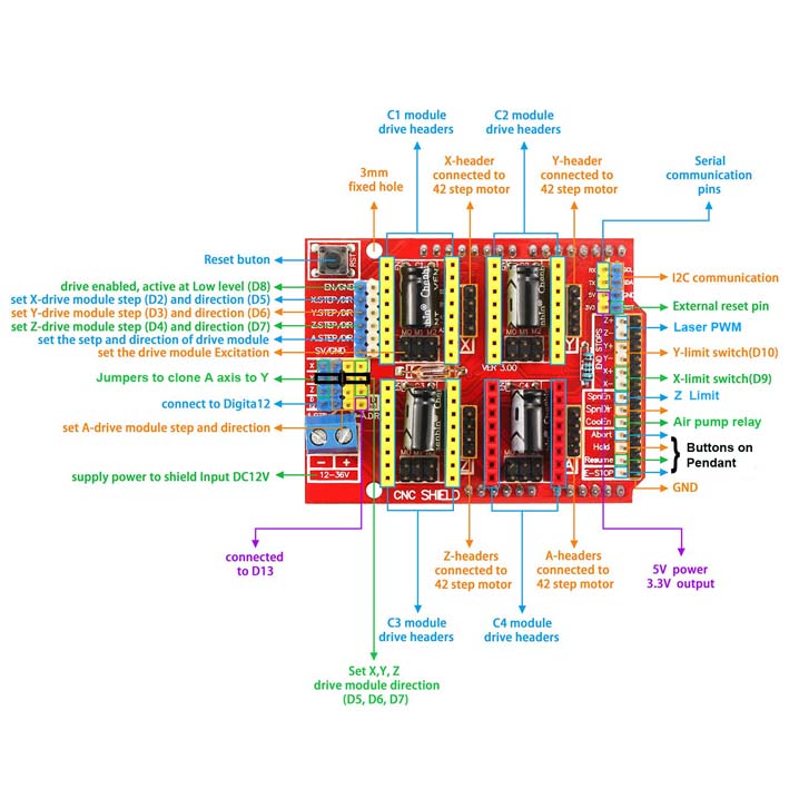

Dave I might need some help with this. The sensor looks ideal for what I want to do, but I am using a Uno board and GRBL 1.1h,
The only pin I have available is not a PWM pin, so maybe there will need to be some pin reassignments, which I am not familiar with doing.
My wiring for this machine is shown below;

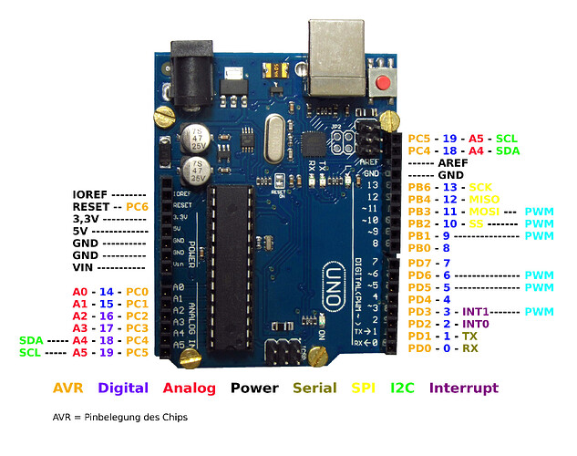

A servo signal does not require a PWM pin.
Leo..
Oh! I was not aware of that. The only pin I have left without making any changes is SpinDir but I think it may also be used in conjunction with another pin
No experience with that shield. Have to dig into the schematic and pinout.
There could be an analogue pin free for that servo signal.
Leo..
Maybe this will help?
Uhh, no. The question was about which pins the shield uses.
No experience, but Google says that with a CNC shield pins A4, A5 are free to use.
Note that there is no PWM functionality on pin 8,9 with the servo library.
Leo..
A5 is the probe pin
8 and 9 I am using already for other things
