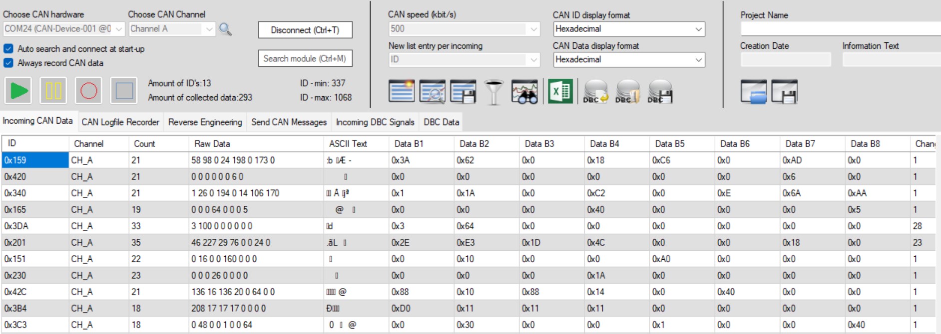

This shows the incoming CAN messages tab. We want to be able to see the sent messages from our SW inside this tab as well.

Thanks for the response. I am actually fully aware of that. It is more of a SW tool design that I am trying to accomplish. This way I can monitor a single tab of my SW to show all messages being received and sent. I want to make is so that in the 2nd screenshot, the column titled "Channel" can show "Sent" in place of "CH_A" for example. It is easy to just directly feed it from the sent messages by piping the data in, but I want to have that piece of mind that it is truly sent and then read on the bus.
