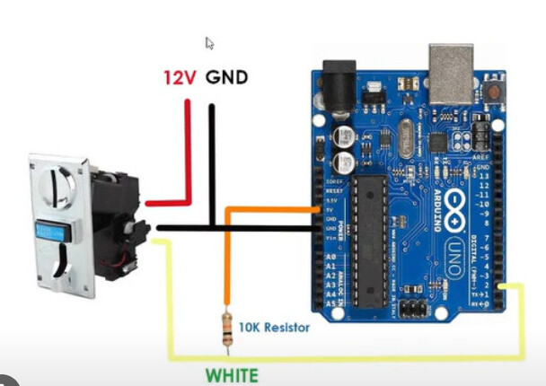

I have fried about 3 boards already, can anyone help me sort out my situation.
Is there something Im missing in my connection? TIA
