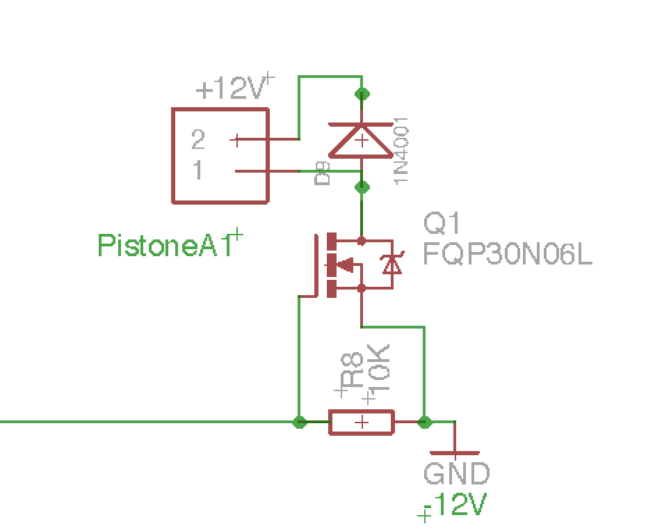

Hi again, guys!
This is my schematics: Schematics.
And this is a picture of it: Picture.
I tried to improved it after having tested the whole circuit on Arduino UNO yesterday night.
Do you have any suggestions or do you see any errors?
If I run the ERC on Eagle, it gives me some warnings, but I'm not able to solve them.
I tried to use NET instead of WIRE, but nothing changed.
Can you help me, please?
Why two 1K resistors in parallel for the green power LED?
And that circuit can't possibly be working with the components shown. An IRF9540 is a P-channel MOSFET, yet you have them connected as if they were N-channel. That can't work.
Furthermore, when you do change to N-channel MOSFETs, they need to be "logic-level", not standard MOSFETs. Only "logic-level" MOSFETs can switch fully on with only 5V applied to the gate.
Also, you should place resistors between the '328P outputs and the MOSFET gates, to limit the current at switch-on.
N.B. "Logic-level" MOSFETs don't typically start with "IRF". "IRL" is more usual.

Put 470R resistors in series with your gate leads to limit gate current with PWM drive.(I know this circuit has 220R)

220 ohms is fine. That's only a little over 20mA. Well within safe limits. (That's what I usually use.)
(Right now, it's more important for him to switch from P-channel to N-channel MOSFETs. :wink: )
Edit: Oh, and it's technically better if the 10K resistor connects the Arduino pin to ground, rather than the MOSFET gate. That way, it doesn't act as a voltage divider. (Not that it makes a lot of difference.)
I replaced the P-Mosfet with the N-Mosfet type: IRF540N.
Do you think it can be OK with this solution?
If yes, I will replace all the other FETs and i'll post again the schematics.
Okay but;
IRF540 is not a logic level MOSFET.
Tom... :slight_smile:
Thank you, Tom, for your support!
I replaced it with the FQP30N06L which surely is a logic level MOSFET :slight_smile:
If it is OK, I will change also all the other FETs.
The package is TO-220 so I won't have problems with the mounting holes.
That's more like it. Logic-level, and low Rds(on).
But you still need to add a series gate resistor.
Aren't you going to show us your code as well?
I updated the schematics by replacing all the FETs and by fixing all the errors, now Eagle says there are no errors on the schematics.
I added a 220R resistor in series with the gate, is it correct? If yes, I will add it to each FET.
