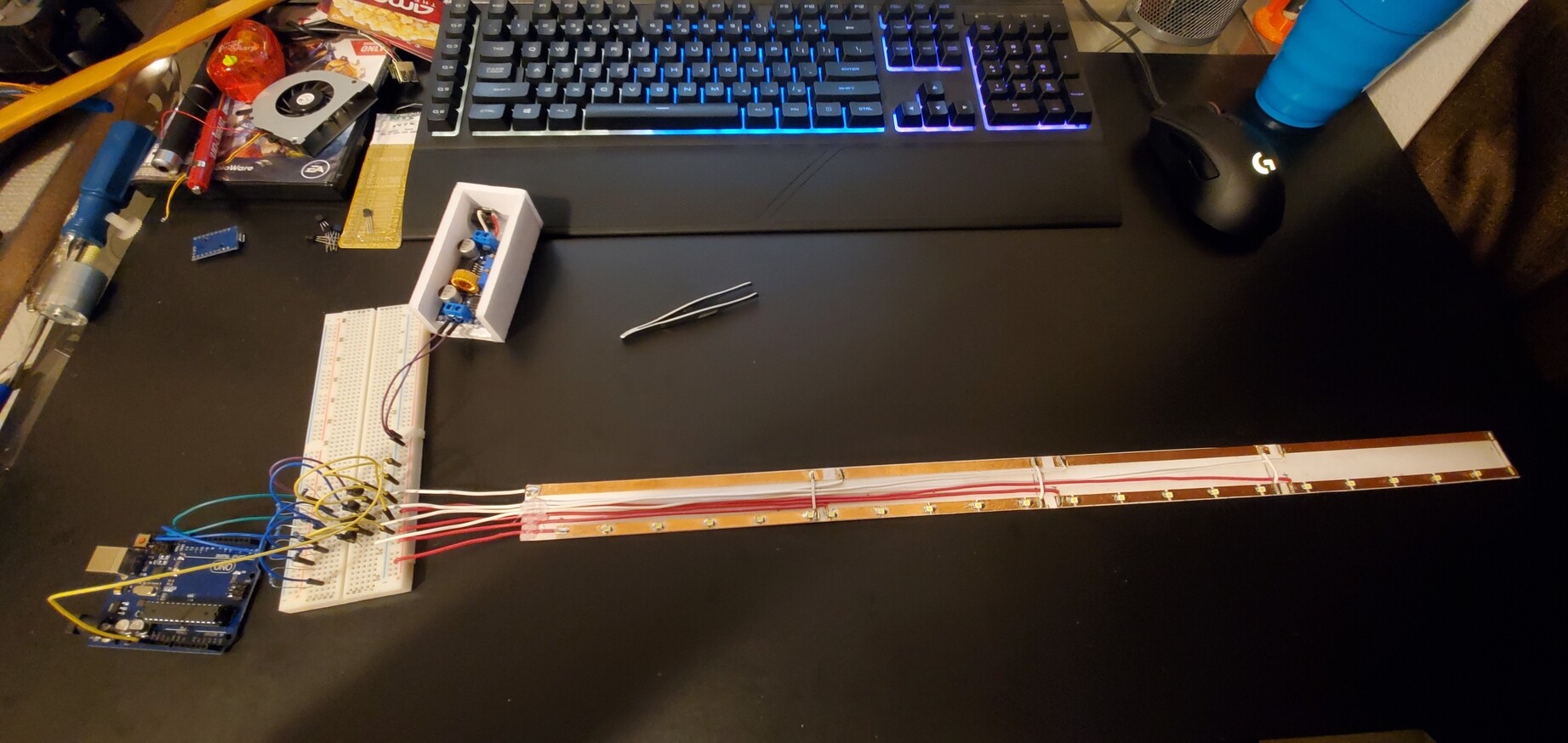

I currently have 20 LED's set up in a strip i made and wired together in groups of five. For the time being i'm using a laptop power supply that puts out 19.5v at 3.6 amps. That is being pushed through the current regulator to put out a steady 16v at 20mA. At 16v and 20mA i can power 5 LED at a time in series but that's not enough to power the eventual 80 LED strips that will be used. The conclusion that i came to in the end was, I didn't need to power them all at the same time. I could keep the output the same but switch from LED group to LED group really fast to the point they all seemed to be on at the same time so only one group of 5 LED is ever powered on at a time. This way i get the most light usage possible from the least amount of power possible(again my goal is to make this all use as little power as possible).
My problem:

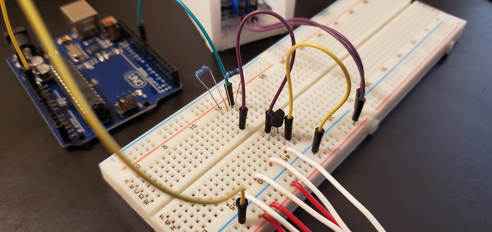

MY current set up, if it's not clear from the pictures, has positive power coming from the regulator into all the positive wires at the same time then through the LED strips and back out into a transistors Collector. The Arduino outputs a 5v signal through two 2k resistors(all i have for now) into the transistors base. The Emitter is then connected to ground and the circuit is complete. This set up works great at slow blinking speeds or constant on for a single set at a time. When i start blinking the sets faster to the point they all look to be on solid(a "delay(5);" for my eyes) i notice that all the LED's are dimmer. I don't have a scope just yet, i only just ordered one tonight. The best i can do is use a DMM. Using this when i read the voltage at one of the LED groups i measure around 10v when flashing quickly. I thought at first this was due to the DMM not reading it fast enough because it's switching on/off and settling at that voltage but then realized that wouldn't make sense because then the LED's wouldn't be dim. When fully on i measure 15.8v at a group and obviously those LED's are brighter.

For easy visualization i only took a close up picture of a single group wiring but normally it would be times 4

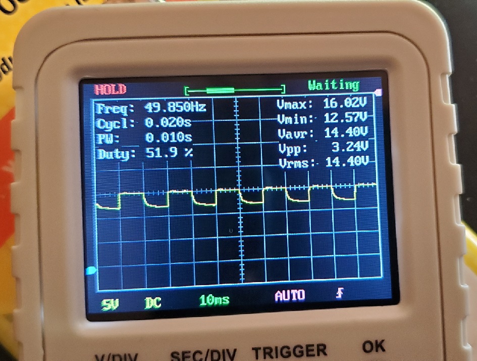

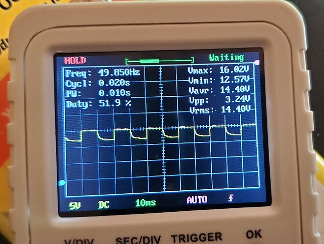

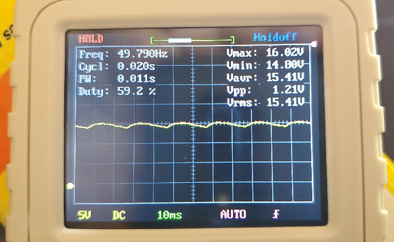

To both Grumpy_Mike and DVDdoug thank you for helping me. I did a bit of research and now have a better understanding of what's going on. Thanks to that i realized what i needed to do to get the results i wanted. I ended up using a capacitor on each group to keep the LED's powered just long enough so when the cycle came back around they already were on. The result was a higher overall brightness and much less obvious flashing at longer delay times.
Different sized capacitors yielded varying results:
No capacitor install- max/min of 16/0 volts
50v 100uf capacitor- max/min of 16/12.5 volts
16v 330uf capacitor- max/min of 16/13.5 volts
16v 470uf capacitor- max/min of 16/14.8 volts
I've also ordered some higher voltage and capacitance capacitors to give me more headroom so i'm not running the capacitors at their limit and for better results.

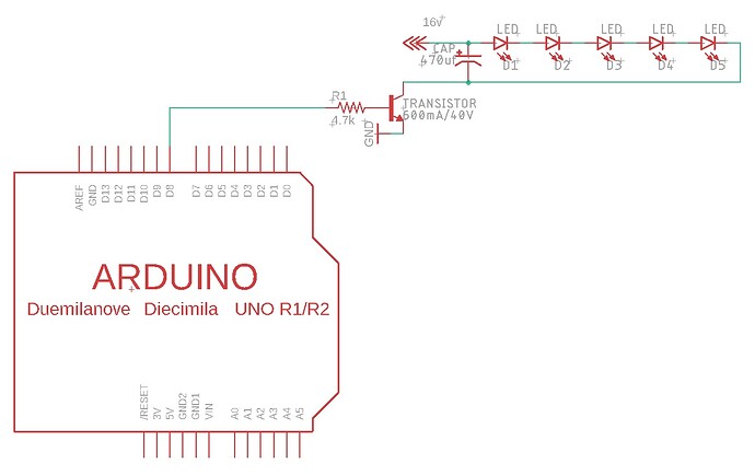

Attached are pictures and a .gif from a cheap oscilloscope i got so i could visualize what was going on as well as a circuit schematic i drew up for better visualization, the old version simply didn't have the capacitor in the circuit. There will eventually be about 16 of these circuit groups but i didn't draw those in because they are all the same and it's easier to see whats going on with just 1. This was honestly my first time drawing up a circuit so forgive me if it looks weird or non standard(if that's a thing idk).
Here is a link to a .gif of two LED groups in action in slow motion running the code shown below. One has the a 470uf capacitor installed the other does not.
https://gph.is/g/4DLeBGw
Edit
To clarify there are no resistors on the LED's in the schematic because my power source is voltage and current controlled to output 16v at 20mA.

Your explanation of what you are attempting to do is a bit confusing. From the description, it sounds as if you want all the LEDs on at full brightness all the time (or at least the same brightness all the time), but don't want to supply the necessary power to do this, so you think by switching among different groups of LEDs that somehow the single power supply will give you full brightness on all the LEDs while only consuming the power needed for a single group. It just doesn't work that way - if you only have two strips of LEDs, and alternate the power supply between the two strips, then each strip will only get half the power it would if it had its own power supply. Three strips, and each strips averages a third of full power, four strips is a quarter of the power, etc. You will always get a dimmer LED when powering it less than 100% of the time, unless you increase the current above 20mA for the time it is powered (not an uncommon technique in scanned displays).
No sorry but life doesn’t work like that. By flashing the light you get less light because it is in less of the time. That a 50% duty cycle you get exactly half the light. It might not look to you that it is half the light because the response of your eye is logarithmic, but a plant will get half the light.
What you are doing with the capacitors is just increasing the current from your power supply during the on time to compensate for the off time. So overall you use just the same current, and hence the power as you would have used if you just set the duty cycle to give you the same brightness. You save nothing.
So what actually happens is the voltage output is reduced until the current is 20mA. So charging your capacitor is going to take more current so the voltage is dropping. But when the LEDs are off there is nothing limiting the current from the discharging capacitor and your LEDs will get more current than the maximum. This damages them by reducing the light output they produce over time. It might take a year to be noticeable but the light output will slowly decline from the off. You could measure this with the right equipment and probably see the light reduction after a week.
