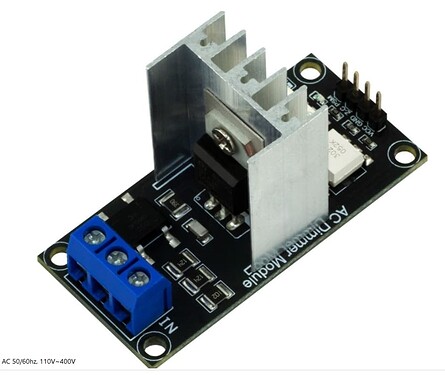

Can you also consider alternative solutions which provide better isolation from mains voltages such as (1) a low voltage fan or, if it must be at mains voltage, (2) a solution with an optically isolated triac/diac pair such as described here: Dimming effect by zero crossing detector and a triac
You can also get ready made modules: https://robotdyn.com/ac-light-dimmer-module-1-channel-3-3v-5v-logic-ac-50-60hz-220v-110v.html
Even if you get your current solution working satisfactorily, absolutely everything has to be insulated to prevent the user coming into contact with any otherwise exposed metal parts.
Also 12v LED PSUs may not be isolated. In my experience they are dreadful, poorly regulated, cheaply made, best avoided except for their intended application.
