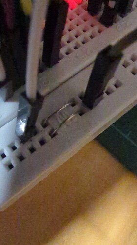

It isn't likely related to your present problem, but if you're using your breadboard as a power distribution center for the current needed for servos, you'll be back, asking why it doesn't work, is unpredictable, or actually fried your breadboard. Breadboard contacts shouldn't be subjected to any more than 100 mA, if you want to use the breadboard indefinitely. Use a power distribution board, a set of wire nuts, or lever-nuts to fan out your power supply current.
Aaahh ok thanks for this, you just saved my breadboard as I was planning to power the servos independently from the PCA9685
Ahh, the joys of sarcasm. Enjoy!
See here is the problem with solely text based communication cause I actually ment thank you yet I can't tell if your sarcasm post was sarcastic about my from your pov sarcastic post, so was your sarcastic post a response to my non sarcastic post that may have come off as sarcastic or am I thinking to hard about this?
Guess we'll both never know. Ironic.
Talking about breadboards, some of the long ones like in your picture have the power rails split in the middle so the left side of the red and blue lines are not connected to the right side.
You can see if that’s the case for your breadboard as the blue and red line are interrupted towards the middle.
(100mA in the breadboard is being hyper conservative you can definitely pass way more under 5V but I second the opinion that you don’t want high current in breadboards in general as you might have undesirable consequences and there should be no breadboard in a final / permanent installation - those DuPont wires will likely create issues).
I don't know how illegal this is in electronics but I may have cut off the leads of a resistor and used the wire to join the two sides
I do the same - with insulated wires - just in case (a short circuit is never that far away :slight_smile: )
