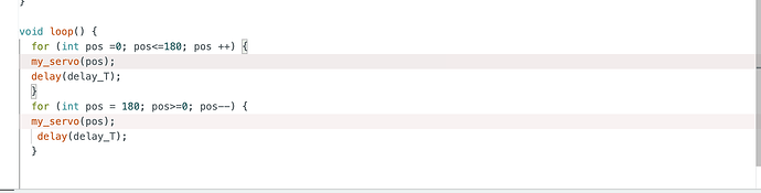

Why I need to use write() in here
instead of use raw my_servo(pos)
my_servo is the name of your servo object
write() is a function in the Servo library that moves the specified servo to the position given
Hence my_servo.write(pos);

you can see the public API for the Servo class in its .h file
Show us the sketch to do so.
