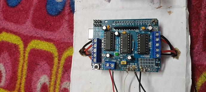

OP, is the shield that you have an Adafruit motor shield V1 or a copy thereof?
@nah_but_a_begginer please post a high-resolution picture of your motorshield.
maybe two pictures one showing the hole shield a second picture with zoomed in on the chip so that the printed letters on the chip are readable
Before posting the second picture check if the letters are really readable on the picture.

I know the shield doesnt looks too tidy. Sincere apologies for that

I dont guess i have a copy of Motor shield
You have indeed an older version of the motor-shield
Here is some documentation and tutorial about it
This shield uses a so called shift-register for driving the L293D-chips.
This means you can drive it only with the special motor-shield-library
that is required for this shield.
You can't drive the motor by a simple digitalWrite(pin,LOW(HIGH)

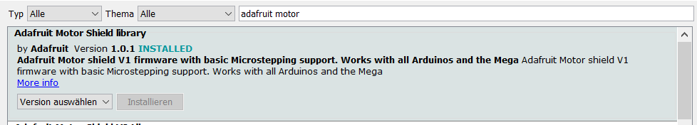

You can install the library from the library-manager of the arduino-IDE.
Make sure that you install version V1
