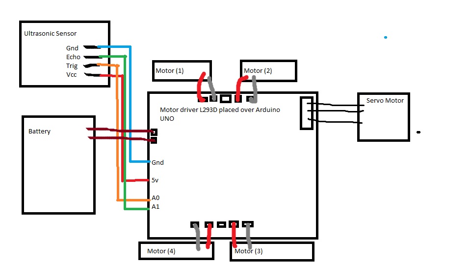

This is a code. Can you please explain whats Schematic?

I've bought the items from a Nearby Electronics shop & can you please explain a Schematic?
Motors? Servos?
A schematic is a hand-drawn picture with only horizontal and vertical lines that shows how all components are connected electrically together.
A schematic does NOT show the real ways how the physical wires go from left to right etc.
A schematic shows the principle in a way that makes it easy to analyse what is connected to what by DIS-regarding the physical distribution of the components.
Take a look here
best regards Stefan
Put it back in the smoke alarm, and get yourself six AAs as a minimum.

Here's the schematic (thanks for the info btw) :-
How do i connect six batteries??

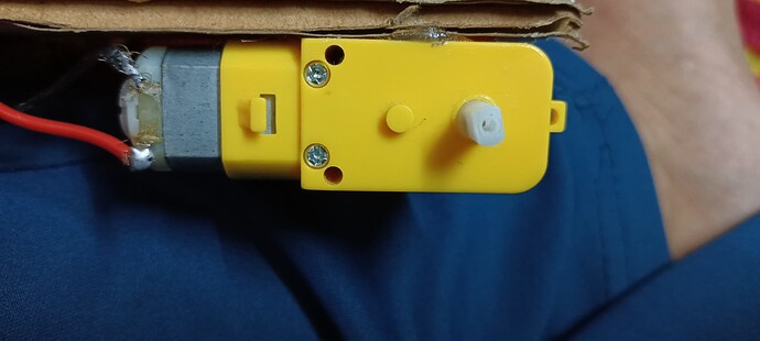

Tower Pro (Micro servo 9g)
And i dont know the dc motor brand name but i can provide the image...

You connect six cells, pretty much as the AAAA cells are connected in your Hi-Watt 9V; in series.
