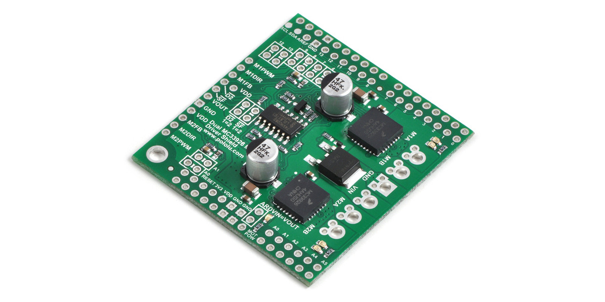

Yes . You can't use an L293 with your motors. http://www.pololu.com/product/2503
Here's one. Google "arduino 1.5A motor shields" to look for others
That is too expensive. I need all components under $30 to finish this robot. How about this one? http://www.ebay.com/itm/L298N-DC-Motor-Driver-Module-Robot-for-Arduino-PIC-AVR-L298N-/251506006357
That is rated for up to 4A so it will work. Before you test it draw a new schematic and take a photo of the schematic and circuit and post it.
I purchased this shield (attached). Please help me out with the wiring now? And the schematic is also attached. I dont know how to use this motor shield now. I did some experimenting and L298 chip on the board got overheated so I disconnected the power immediately (it was attached to 12V battery) , so I dont know if Ive burnt my board or not . :roll_eyes: :sweat_smile:
