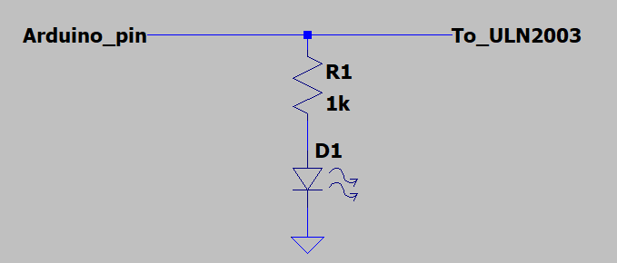

Easiest way is to just connect a series resistor and LED to the digital output that goes to the respective input on the ULN2003.
I have only seen that they connect on the output from the ULN2003?
Is ther any pros, cons with that?

It's just one leg of resistor to arduino pin and to input pin on uln2003, other leg to anode of led, cathode of led to GND. 1k for the resistor should work OK.
Pleas can you show with a picture, I understand better that way. And no mix up.
Super thank you! But why 1k?
Also what would happen if I by mistake set a input as a output or the other way around if I connect as described, with leds and resistors?
5V (Vcc) - 1.5V (forward led drop, approx.) = 3.5V / 1000 = 3.5mA = very safe/conservative current level to draw from a digital IO pin.

It's intended to function as an output.
If you mistakenly set this output as an input, then nothing much happens at all. The ULN2003 won't be driven, the led won't light up (actually, if it's a very efficient smd led, it may light up very dimly if you write HIGH to the input port).
Based on: microcontroller datasheet.
Conclusion: it pays to (1) learn the basics of electronics and (2) read the datasheets of the components you use.
