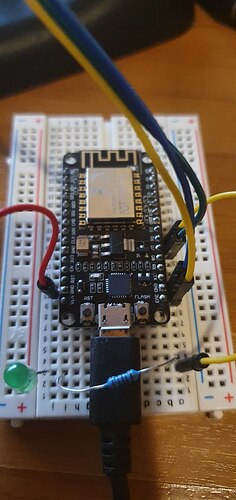

Here is how I changed the setup . I wanted the green pin to light up when motion is detected but doesn't .. I also wanted to add another red pin to show when no motion is detected, what is wrong in my setup ?
I used 220 ohm resistor.

jcheck the PIR is working
remove it from 13 and connect a jumper from 13 to high then low - does the serial monitor output change as expected
Edit: connected a PIR (similar to your photo in post #1 ) and it works OK detecting motion
as @6v6gt suggested try adjusting the sensitivity - see arduino_pir_sensor

Post a link to that PIR detector. Some have adjustable delays and jumpers to configure their behaviour.
How you mean ?
If I detach the d7 connection the monitor says no motion .
erm how I see that? ITs the standard PIR Sensor that come out with the elegoo 2560 pack .
Ok here is how looks the setting I guess....

try removing the delays in loop() you may be missing the pulses from the PIR
This is what happens if I remove the delays
I have setup the sensitivity and temp like this
minimum distance should be 3 m and max time
this is the actual config
I had to disable the resistor to switch off the led to take the pic otherwise the led is always green on and the thing keeps signalling presence ... what can be the issue?
