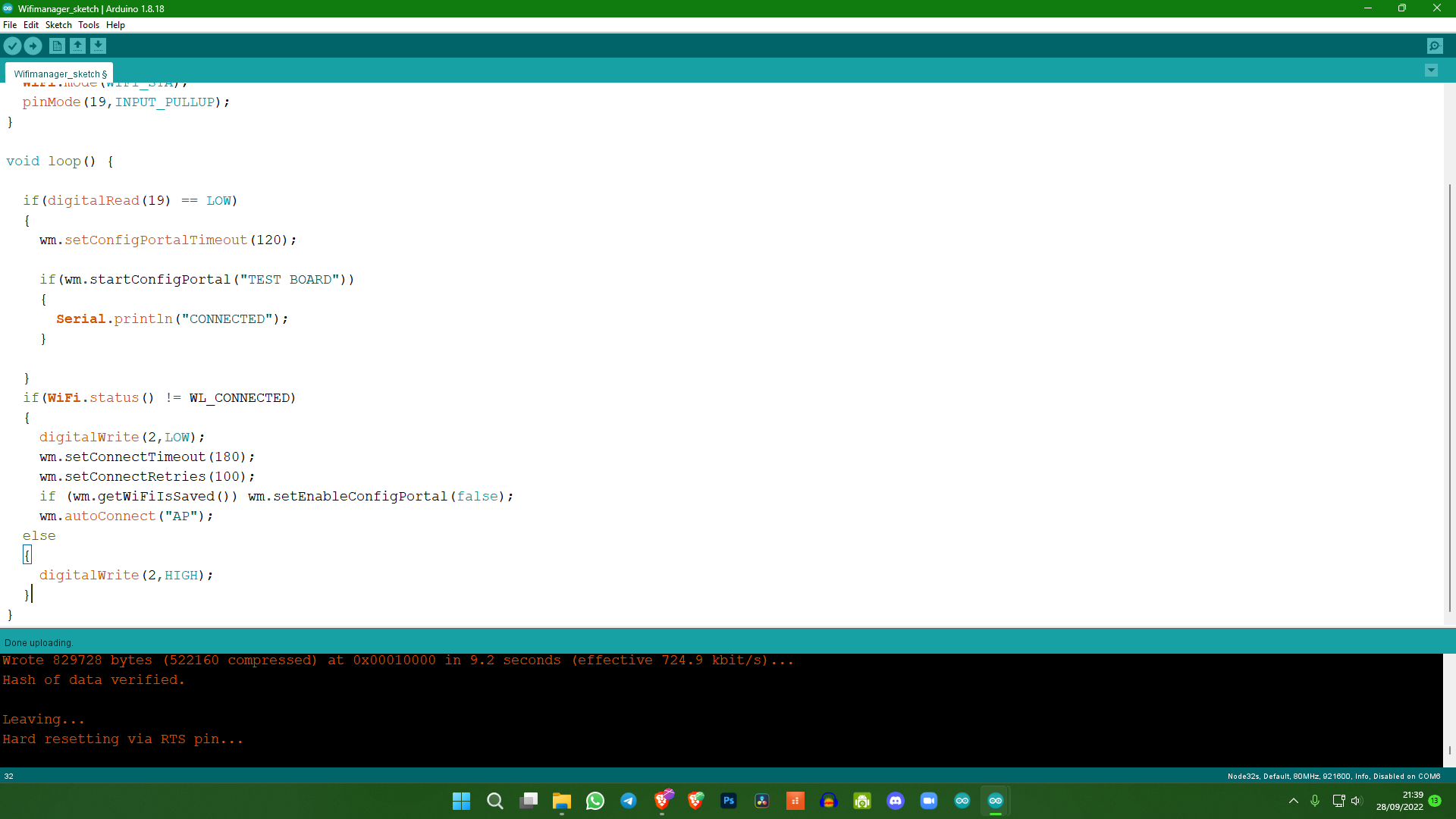

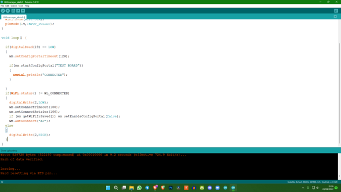

Hi @jackkitley this is also what I am looking to do, thanks for posting the solution, although I am confused where I should put the code. Are you able to post where it should go? Thanks
Hey @ajtaylor79 , I was working on an ESP home automation and was trying to figure out how to reconnect to same wifi network.
After days of trying everything I came across this thread and figured out where the above mentioned part of the code is to be placed.
Just take a look at my code and you might figure it out yourself!
also really thanks for the code snippet @jackkitley
it helped me a lot!

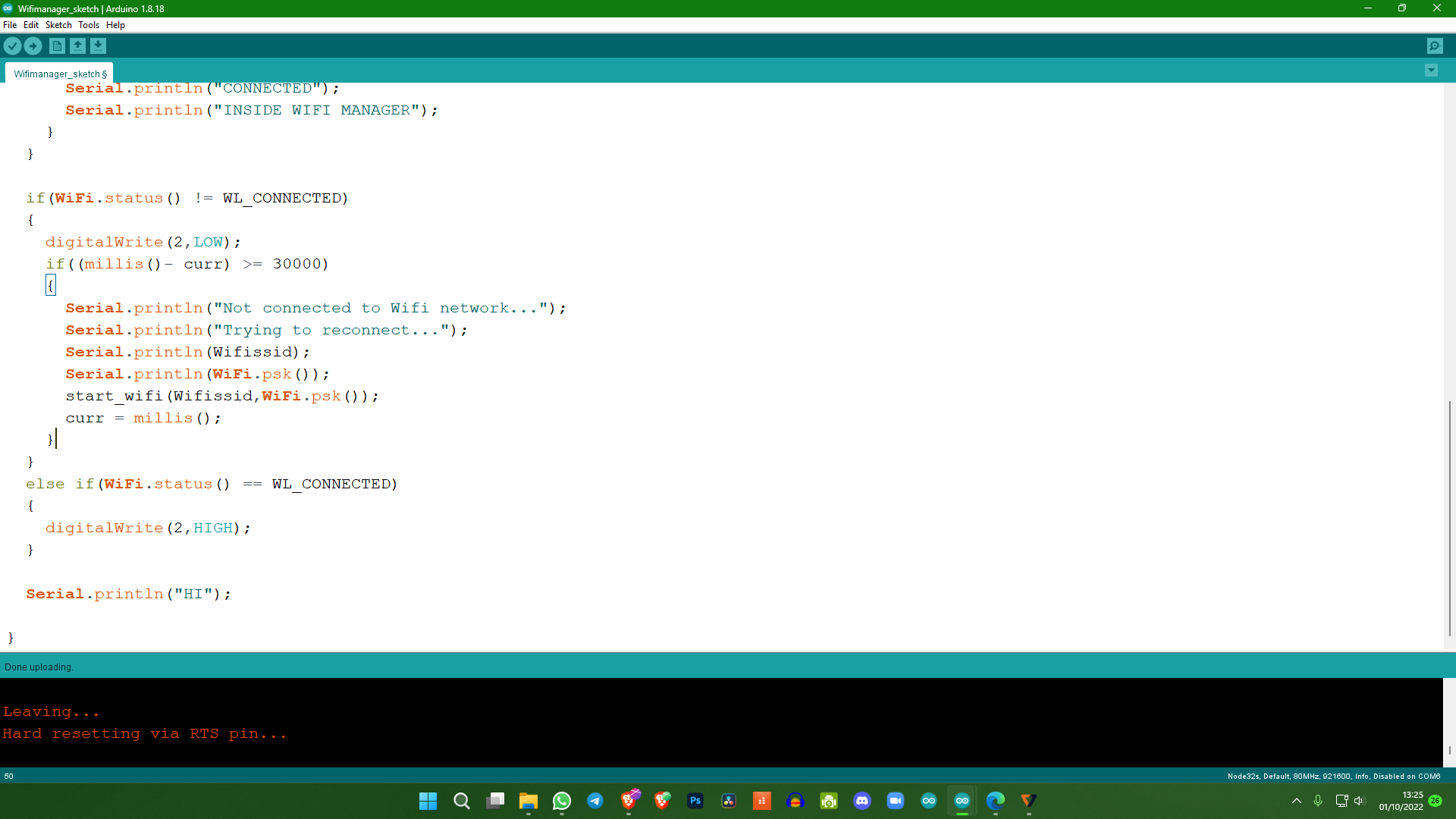

@ajtaylor79 Hey dude I also found another solution, Where my code uses WIFI MANAGER to initialize the wifi networks.
But if the wifi is connected and disconnected, my code tries to reconnect every 30secs (reconnection time can be changed).
Apparently when the wifi manager class is declared in a scope, the WiFi.begin() function isn't working idk whether it is to me or not.
the getWiFiSSID() method present in WiFiManager spits out the previously saved wifi SSID and if there is no SSID stored, it returns garbage value.
