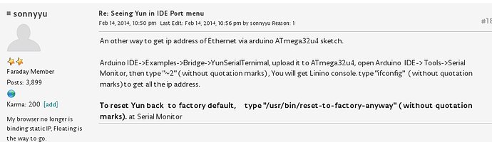

Also, typed in as sonnyyo advised, but then again in the serialterminal, is that right? and nothinbg came out of it...
No, that command is for the Linux command line, after Linux is fully booted up. Your Yun is failing during the boot process, so you can't run that command yet. That command is what is called when you hold the WLAN RST button for 30 seconds (which also won't work until Linux is fully booted up.) Typing that command is just a faster way to do the reset without holding the button for 30 seconds.
