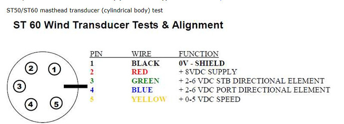

@johnerrington's suggestion that it may be open collector deserves a closer look based on the apparent fact that the signal is different based on whether or not the display head is present.

Hi, @gilow
Looking at the pinout of the unit;
If the unit is supplied with 8V and gives 0 to 5V pulses out, there is possibly some active electronics inside the unit.
This makes sense because of the long wires needed in a marine/mast mounted environment.
Have you tried connecting 8V and measuring the pulse output with a DMM, with respect to the shield, as you rotate the vane by hand?
With your 393 circuit, have you set it up with hysteresis to help minimise noise?
PS. Eagerly awaiting a schematic.
