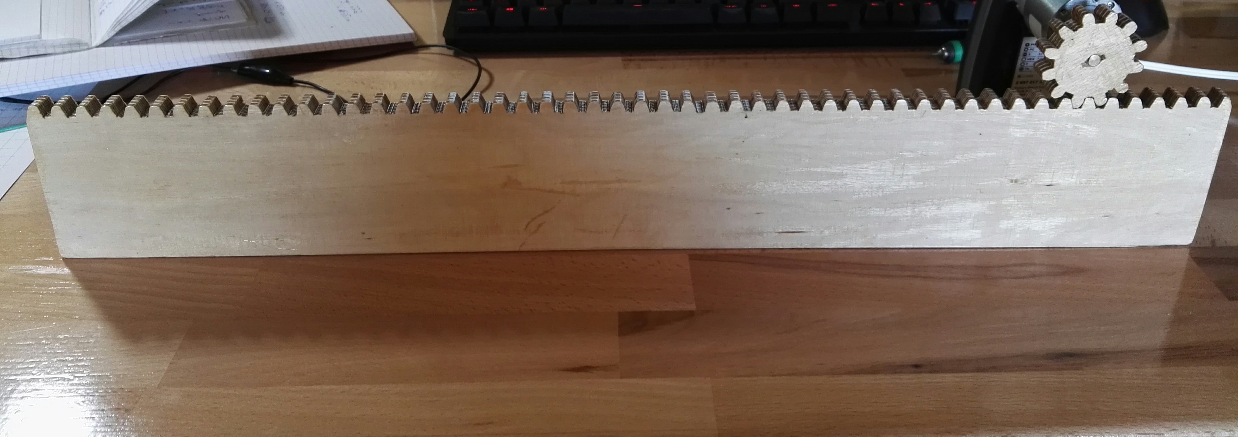

I am trying to whrite a sketch to open and close a greenhouse window based on temperature.
The setup is as follows:
-Arduino Uno
-6 channel relais to shut the motor on and off and to reverse polarity
(similar wiring as in this video by SimpleCircuits: YouTube?
v=BQOji4i4PEc&t=66s&index=24&list=WL )
-12V DC geared motor (3.5rpm)
-rack and pinion assembly for the sliding window (see Attachments)
Here is my code so far:

My problem is that when I upload the sketch to the arduino first everything seems to be working properly: If the temperature reading is above the threshold, the motor runs and opens the window and vise versa. But when the temperature stays above the threshold, the window "opens" again.
This behaviour would cause failure in the final project.
I tried creating a second Void loop, but as we all now, that doesent work.
I also thaught about end switches, but I dont really know how to incorporate them into my sketch and would like to avoid the constructional challenge of attaching them in a waterproof way.
All that leaves me wondering how all those other arduino greenhouse automations work.
If it where possiple to avoid using libarys I would prefer not to use them for the sake of simplicity.
