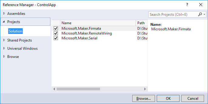

I have also put two pictures as attachments from project's Reference Manager.

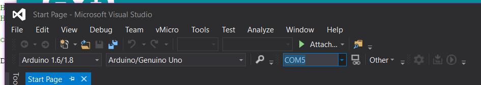

Well i have just started using visual studio, and i am not sure if this will fix your problem, but maybe ?
Th attachment shows the top of visual studio, from the error you get i think you have the serial port wrong, mine shows com5, that is my only choice as i use just one kind of board, you may have more choices.
