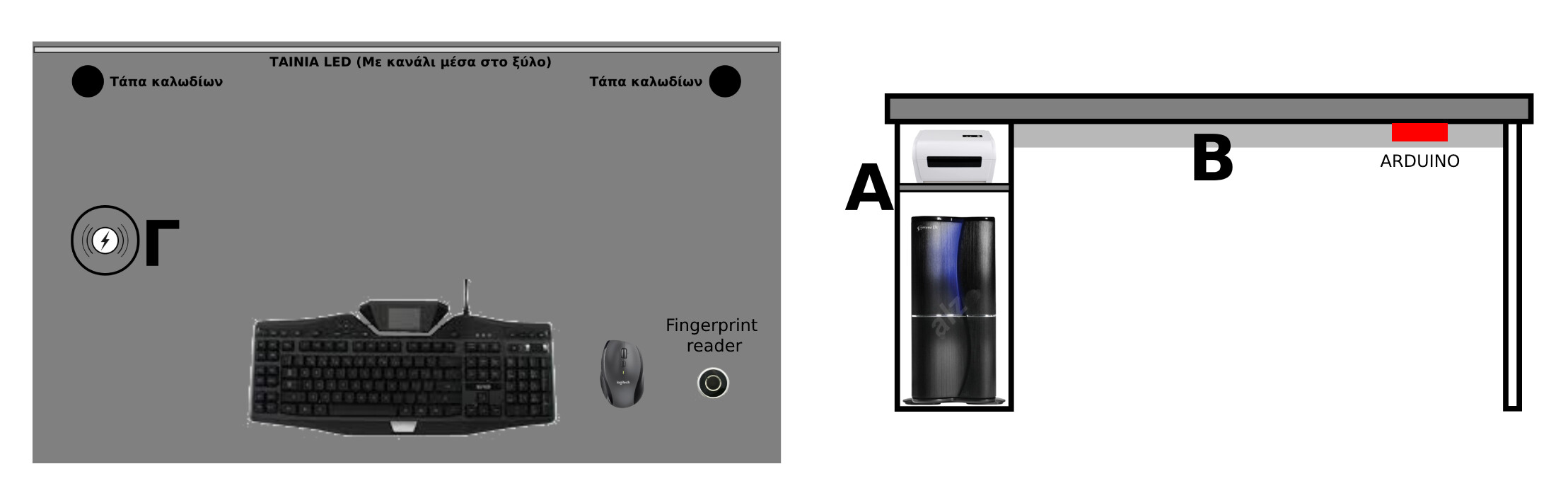

I am building an office and I want to integrate on its surface a fingerprint reader with which I can enter windows when I open the pc or unlock folders that I have inside the pc.
I saw that many use the Arduino.
I would like to make a construction that does not have to interfere with the computer motherboard with cables and so on. I would rather connect it simply to a USB which from what I understand is done with the Arduino UNO which has a USB port.

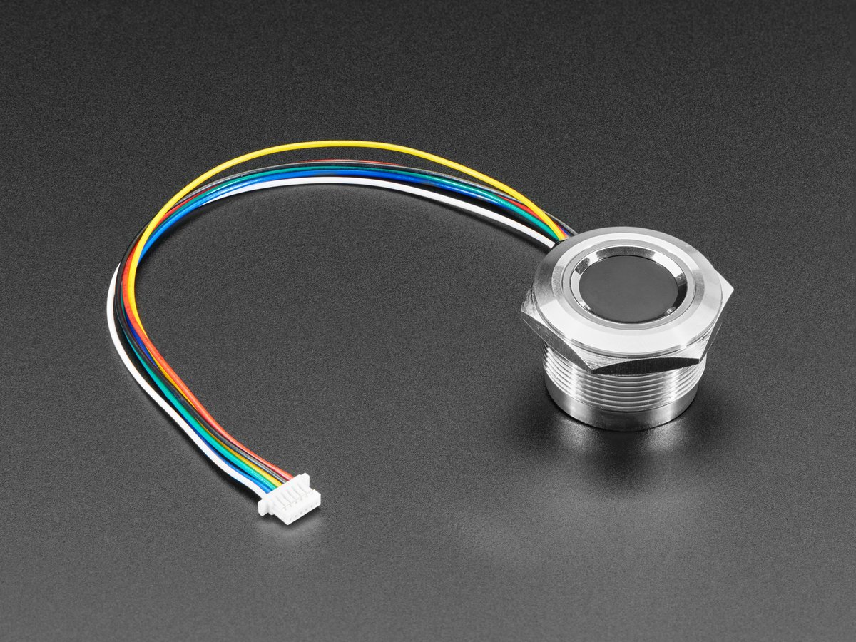

If supports it, I want to put a fingerprint like this
Ideally I would like a solution like this:
To "pin" a fingerprint reader on the Arduino, to connect the Arduino to the computer with a USB cable and then to install on the PC what is needed so that I can unlock the windows with a fingerprint

R502-a capacitive fingerprint reader module sensor scanner small thin circular ring led control dc3.3v mx1.0-6pin Sale - Banggood.com-arrival notice-arrival notice and R503 capacitive fingerprint module sensor scanner circular round two-color ring indicator led control dc3.3v mx1.0-6pin Sale - Banggood.com-arrival notice-arrival notice
This is what we are looking for the 503: http://myosuploads3.banggood.com/products/20200617/20200617011838R503fingerprintmoduleusermanual.pdf.
And this for the 502: http://myosuploads3.banggood.com/products/20200617/20200617011758R502-Afingerprintmoduleusermanual.pdf
From the product pages, it has a TTL serial interface that you can use for communication with an Arduino.

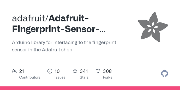

Arduino Library: (Adafruit)
Code Examples:
Enroll: Adafruit-Fingerprint-Sensor-Library/enroll.ino at master Ā· adafruit/Adafruit-Fingerprint-Sensor-Library Ā· GitHub
Fingerprint: Adafruit-Fingerprint-Sensor-Library/fingerprint.ino at master Ā· adafruit/Adafruit-Fingerprint-Sensor-Library Ā· GitHub
