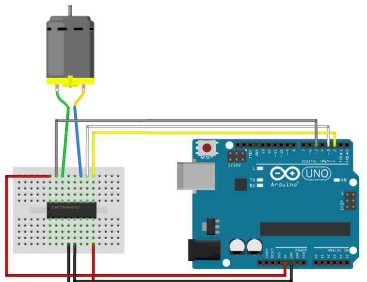

The buttons are connected normally with 10k resitor and to the pin described in the code.
The rest of the board so motor,H-bridge and other wires are connected like the picture
with all the black wires on GND and red on the 5V.
I hope someone can help me because i have tried everything i know.
Aren't these motors 12V?
Are you really trying to power a motor from the Uno 5V? Motors need their own, external, power supply capable of supplying the motor rated voltage and stall current.
What is the rated voltage of the motor. The L293 motor driver drops 2V to over 4V of the motor supply voltage. With that driver chip and 5V motor power the most that the motor will see is 3V. The L293 is an ancient and inefficient motor driver. There are much better modern drivers available.
Can you use switches instead of momentary buttons? Most cars have switches,
I'd use switches (or one rotary switch is ideal). Otherwise, you'll have to keep track of the last button pushed and that would probably be a separate function, probably with an interrupt when a button is pushed.
With a switch, I'd use a switch-case function to select which function is called.
Then each function runs a loop that checks the (physical) switch state at the end of each loop and returns from the function when the (physical) switch selection no longer matches the currently running function.
unfortunately we can only use buttons
@groundFungus @jfjlaros yes it is im sorry i cut the picture badly this is the whole setup
Tell us more about the actual wiper motor. IS it just the motor, or does it also have the gearing to rotate the wiper back and forth? Does it have extra wires for the home position? Do you realize the motor will take MANY amps at 12 volts to actually run?
Much better, but the motor will get just 4V, at most. Is that enough?
i tried it at the lowest rpm it needs to run on (60) and it runs fine without any trouble

Ok, then there is NO windshield wiper involved, just a simple DC motor. Have you done the logic flowchart, yet? Pretty important BEFORE doing any coding, other than motor testing.
these are the only flowcharts i have made:
just to clarify, the code does work to a certain extent. It wil start and when i press one of my 4 buttons it wil go into the if- statements i intended it to go but it wont get out of the loop as in, it doesn't look at the button inputs after being in one of the if- statements
That's due to all those delay(1000) and delay(1800) etc, which block the code from looking at the buttons. This project calls for being re-factored with a blink-without-delay() approach.
