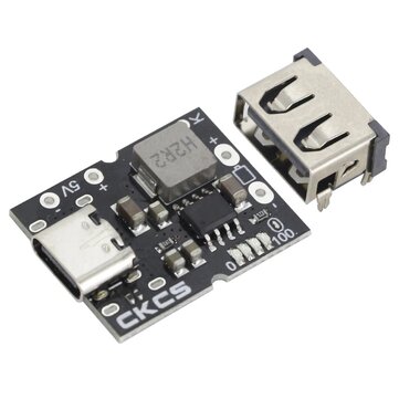

MKR 1010 is almost the same as Nano IoT but has an IC to handle a battery
I agree with @Juraj but just in case you want to stay with Nano 33 IOT you should add a battery charge an discharge control board to allow your arduino run while is charged
there are many options and qualities of board capables of doing simultaneously charge and power arduino
I share my experience in two battery powered projects that are running smoothly
one with continuous Charging connection that uses battery as backup power.
(this is realy important to keep the battery out of the limits)
and the other with complete charging and discharging cycles between uses
I've used this module many times with success, but it's necessary to have it from a known quality source:
or even this :
with usb-C connector (allmost the same circuit)
as these boards made made by several fabricants , not always with the same quality control.
advantages :
realy not expensive board
simultaneous charge and use
battery overcharge and over discharge protection
battery level leds
on/of switch key (it can be used control the power on/of of your device)
considerations:
some vendors are poor quality
maybe its necessary to use an output capacitor to avoid power breaks when switching between charging and battery
