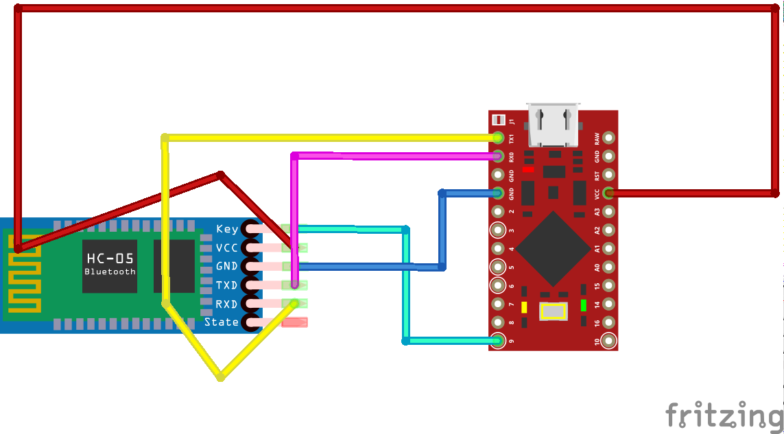

Wireless communication with PC and Arduino pro micro using HC-05 bluetooth
I am following this tutorial: Arduino Playground - Tutorial01
I am using Sparkfun Arduino Pro Micro with an ATmega32u4(3.3v, 8MHz) on it (https://www.sparkfun.com/products/12587) and a HC-05 Bluetooth Module. I also running this on Windows 10.
I've made these connections: with some additional for leds
Arduino Pro Micro TxD (Pin 0) -> HC-05 RxD HC-05 TxD -> Arduino Pro Micro RxD (Pin 1)
I have two Serial ports available for the HC-05 COM30(incoming) and COM31(Outgoing). When I try to send letter 'H' in Serial monitor on COM31 the arduino ide freezes and the HC-05 flashes rapidly. When I try to send letter 'H' in Serial monitor on COM30 it sends but nothing happens as H should ideally turn on the led. The arduino pro works with a button but I would like to send the command externally as in the tutorial. I also try in processing but the same thing happens as when using the arduino serial monitor. I have been trying for a couple of days now with no idea why it is not working, I have tried adjusting baud rates and changing to Serial1 with no change.

SamJam1:
This is a guess:
The rapid flash signifies "power on , ready to connect". Assuming the HC-05 was already properly connected, the rapid flash is now actually saying. "I have been disconnected, but power is available and I'm ready to connect again"
You might conclude that it's a power problem, more specifically, there isn't enough, and you don't say anything about it. I don't know anything about powering the Pro Micro. Please don't tell us you are using a 9v PP3 battery.
You might be better off dispensing with the LEDs and just proving the bluetooth is kosher.
You might find the following background notes useful
http://homepages.ihug.com.au/~npyner/Arduino/GUIDE_2BT.pdf
http://homepages.ihug.com.au/~npyner/Arduino/BT_2_WAY.ino
Nick_Pyner:
I am powering the pro micro through a lipo charger basic using a 3.7 v lithium battery.
Thank you for the notes! I will use these and try to get down to the issue
It sounds like it is enough - but only just enough, and I would be suss about it. Testing the battery for service voltage would be wise.
Nick_Pyner:
I tested the voltage I'm getting and its 3.9v once I connect to COM30 (incoming) it flashes every two seconds instead but still I can't transmit data to or from the Bluetooth module. Thank you for your help.
SamJam1:
The power should be OK. Assuming you are talking about the LED on the HC-05, flashing every two seconds suggests it is in AT mode and therefore will not communicate. LED activity in comms mode depends on the breakout board you are using. It is usually solid but may be off or off with one blink when there is traffic. Your problem smells like wiring - too much of it. You need four wires only:- Pwr, gnd, Tx, Rx -no buttons, nothing extra.
"Power on , ready connect" is about two flashes/sec.
