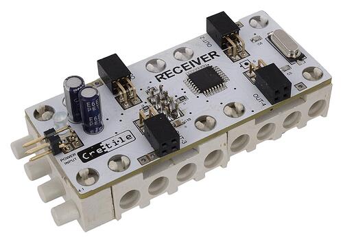

https://www.cretile.com/product/cretile-receiver-transmitter
have look at above link the are using NRF24L01 without micro controller
will it be posssible
vijay_45:
Those must be plugged into a microcontroller module to work - they don't work stand alone.
Those pictures of Cretiles are interesting. I do not know anything about Rs so I cannot advise on price.
The transmitter shows an antenna already integrated into the PWB module. A controller is not shown but has to be there.
The receiver shows what is probably a controller. It does not show an antenna but it has to be there.
No information was provided about the 433 MHz modules so I cannot advise on a comparison.

aarg:
Look again at the magnified pics and this quote.
Cretile Receiver and Transmitter works together. As the name suggests Cretile Receiver receives signal wirelessly from Cretile Transmitter. The output port values indicate what is received. Receiver has four outputs.
They are configured as garage door remote tx/rx, 4 digital inputs and 4 digital outputs.
The aerials are on the NRF units.
One NRF Tx/Rx Unit is on top of the pcb, Tx
One NRF Tx/Rx Unit underneath the PCB, Rx, you can see the NRF pin cluster and the onboard controller chip.
Cretile is a modular connection system.
