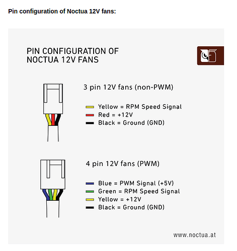

I've been trying to find where I have gone wrong with my fan wiring as everything was working properly and then I moved some wires that didn't involve the fans but must have moved something by mistake.
I have an Arduino Due controlling a LR7843 logic level Mosfet board to turn on 12V Noctua 4 wire fan and it was working properly 2 years ago but I added some sensors and somehow messed up the wiring so I'm trying to put everything back to the way it was and can't seem to find my wiring diagram from 2 years ago.
I was using a temp sensor to turn it on and off and the temp sensor works properly but it doesn't turn the fan off, it just continuously runs. I have a digitalWrite in the setup to turn the fan off on startup but the fan ignores it and stays on.
The Mosfet board inverts the logic so High's are Low's and vice versa.

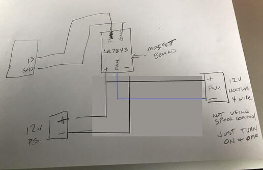

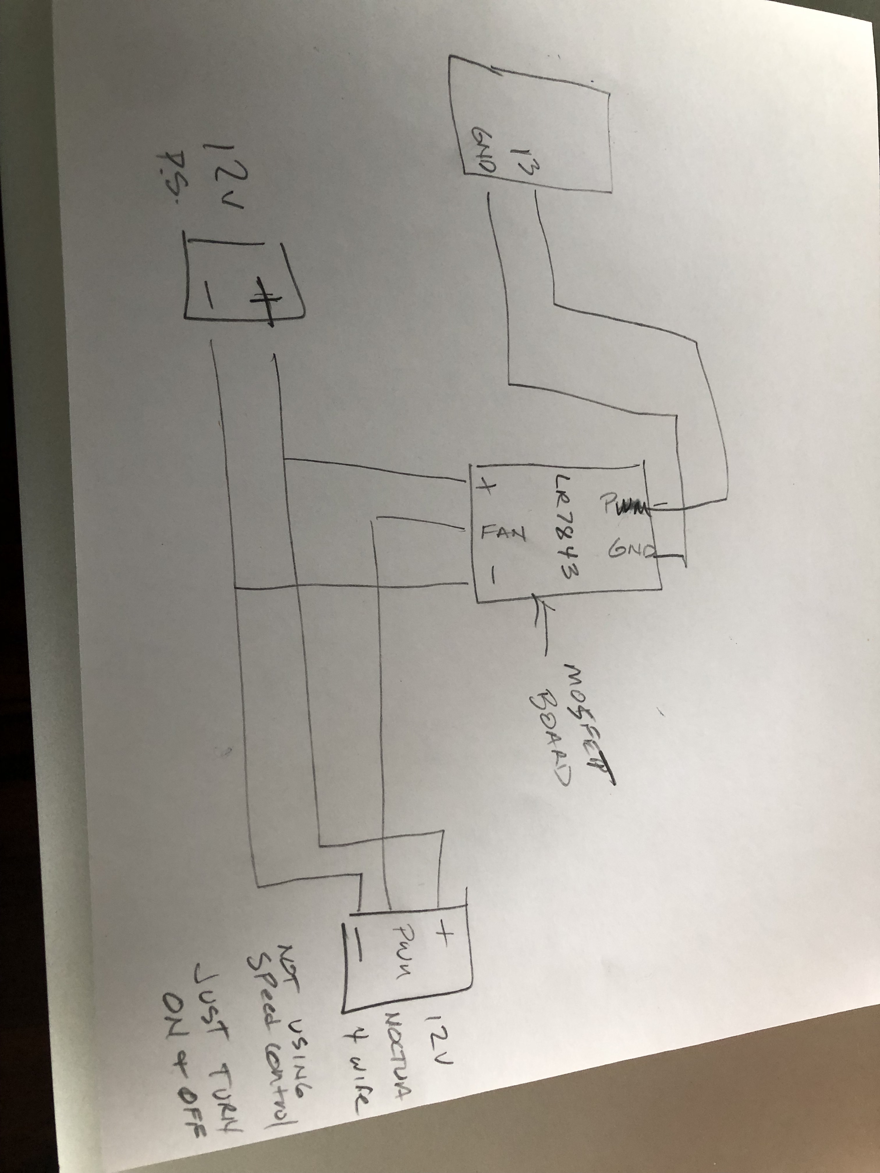

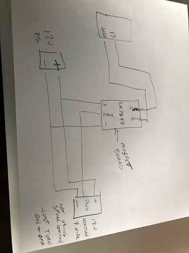

Here is how I have it wired,

either you modulate 12V power with PWM and not touch PWM pin on the Fan
or put PWM from pin 13 directly to Noctua PWM pin

@kolaha All I wanted to do was turn the fan either off or on which is why I didn't bother with the Tach0 line.
Because the fan is 12V I was told I needed the mosfet to switch it on.

You have the fan power leads connected directly to 12V and the MOSFET in the PWM signal line. Are you trying to control fan speed or just switch it ON/OFF/
That's what I was doing and somehow I've messed it up moving wires around.
I do have a DMM and I don't see the LED on the LR7843 on.
I just need it either on or off, using temp sensor for control of on and off.

My Apologies I have not given an accurate wiring diagram, the Noctua fan needs a 5V signal.
Without PWM terminal connected the fan should run full speed,
Connect 12V and MOSFET like this, the diode is needed to protect the MOSFET from back EMF.
Using the Blink example from the IDE the LED on the lr7843 doesn't light up.
You have no common gnd for the PWM to the Fan.

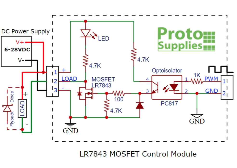

Hi, @1ribbonman
Don't forget the Due is only 3V3 output logic.
The PC817 on the module needs about 20mA to reliably operate the opto.
The module uses 1K series resistor so;
I = V / R = 3V3 / 1000 = 3.3 mA.
I would say not enough current, the spec of the opto may have drifted in 2years to where the LED current is not sufficient to operate the opto.
If you can, measure the voltage across the 1K resistor when activated.

On post#10 you are using the wrong diagram, sorry about that.

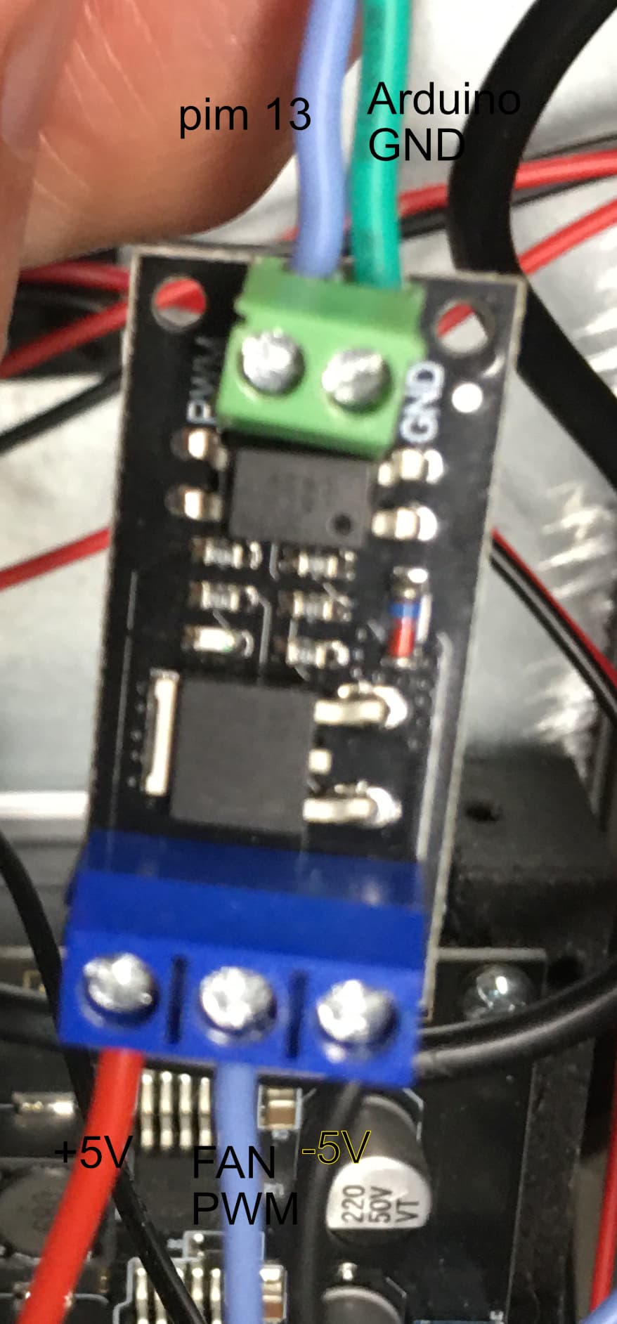

here's a photo of the connections on the Mosfet, The 12V lines go directly to the Fan.
it's hard to read the text on the black wire on the bottom of the Mosfet but it says -5V next to the light blu PWM wire.
I realize the logic problem which is why the Mosfet is being used, the LR7843 is supposed to work on 3v3.

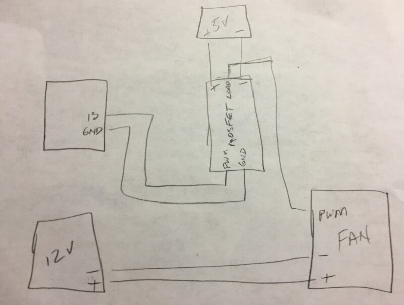

Post the correct diagram.
What is the EXACT part number of your fan?
If you connected 12V to the fan's PWM pin, you may have killed it.
