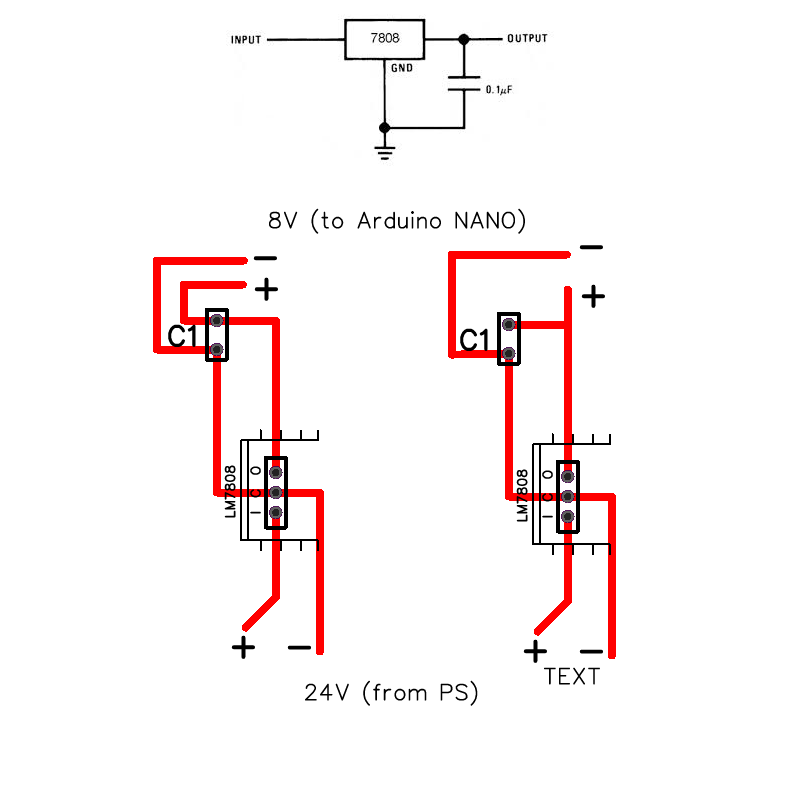

Hi all:),
first I wish to express my gratitude to the creators of Arduino and all his supporters from this forum. I'm really enjoying this new "world", and the info I get from this forum is awesome.
I have read that when using a current stabilizer like the L7808, it is better to put in the output a small ceramic capacitor (that has no polarity), which scope is to filter out interferences produced by the integrated itself.
The question is: in the picture below, are both the wiring doing the same implementation of the schema above?
I know that this question maybe is ridiculous, and I swear I tried without success to get an answer from the web. Personally I'm more inclined to answer positively to the question, but before printing the PCB I thought was better to ask to you.
Thanks
Hi, Welcome.
To answer your question. In theory the one on the left is better. The reason is that wire or clad length reduces the the ability of a capacitor to filter very high frequencies.
In practicality the two layouts likely make no difference.
If I were doing the layout, I would put the capacitor just to the left of the regulator. That would make the clad between the two devices very short, so slightly better high frequency filtering.
Also look at the 7808 spec sheet. I believe there should be a capacitor before the regulator. This will likely be of higher capacitance that the one you have shown. It might be a polarized capacitor.

I said it was better to ask! thank you very much JohnRob for the answer, that is NO!
So I will use the first wiring because I cannot really put closer the capacitor to the L7808.
Regarding the capacitor in input, please tell me if I'm wrong again :slight_smile:
I intentionally removed it because I thought that it was an overkill considerating that the current comes from a stabilized power supply and the 8v output are furthermore stabilized by the Arduino Nano current stabilizer.
Is it still necessary?
I would add a capacitor at the input of the 7808, even is only a 0.1µf ceramic. The 7808 is an analog amplifier that requires low input impedance for stability. You might get away without it but if you can possibly place it on the PCB you would be best to do so.

The idea is to out the cap AS CLOSE AS POSSIBLE to the linear regulator (which for reasons unknown, you are calling a "current stabilizer". I have a feeling Google Translate is to blame.)

The L7808 with the cooler, will be plugged in a three pins Dupont socket, this to make it easily replaceable. So I realize now that the capacitor could be moved immediately close and below the integrated (there is enough height).
But now I wonder if temperatures are a problem: the PCB is fitted in a waterproof box, so everything is perfectly sealed, no breeze will mitigate the temperature of the TIP120+L7808 dropping tens of volts in August!
I want to create something that lasts 10 years! A small capacitor near an IC at 100 degrees is at risk? What can happen it the capacitor, in that position, explodes and has a short circuit?

If you use a chip capacitor, it can be soldered directly across the wires of the regulator.
Not only do you need a ceramic capacitor on the output but you also need one in the input and a larger polarised capacitor on the output. If you do not do then then the regulator might very well oscillate.
You need to look at the data sheet for the manufacture you use, these are different for each manufacturer. It tells you the minimum capacitor value to use.
I don't know how the TIP120 in involved, However the 7808 dropping 24-5=19 volts (a guess) times the current draw of 5 ma (another guess) means you must get rid of 100 mw. If I'm even close you might not be in too bad a shape. However you need to use the actual numbers to be sure.

The "brain" of the system (Nano+RTC+Screen) should not drain more than 150mW, so the L7808 must dissipate (24-8)*0.15=2.4Watt. Is it correct? Can a small passive cooler easily dissipate this amount?

Hi Grumpy_Mike, regarding the larger polarised capacitor on the output, on the L7800
SERIES specs I cannot find this need. Is it really needed,
I once had to scrap a whole days production of set top boxes because some one in purchasing changed the manufacturer of the voltage regulator we used. The new regulator needed a larger minimum capacitor for stable operation. And you are asking about not using one at all!

I think OP is referring to a large cap often seen on the output - in conjunction with the smaller ceramic cap that keeps the regulator itself stable.
Whether you need one of those and how big depends on the overall circuit. It won't hurt.
