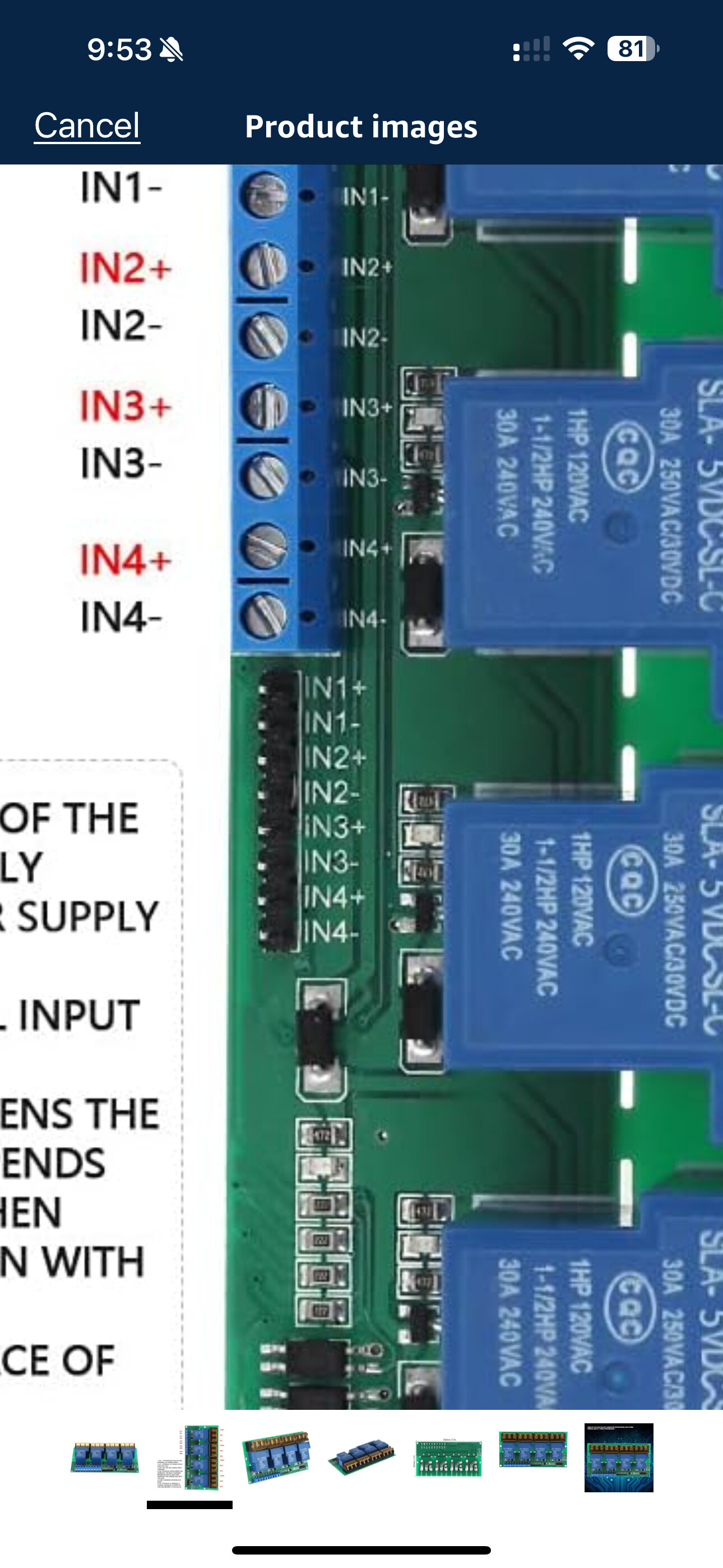

I have bought a 30A relay to replace a10A one, however this relay has a in1+ ANS a in1- socket (the 10A one only has in1).
I am not sure why it has +and- and are not sure how to wire it up. Does anyone know?

Relay module
You didn't mention anything about your board, I expect you have 5V arduino borad.
Two images, which one you have??
It's optocoupled relay module, you power the relay coil separately from DC +/-pins.
Int+ and int- are for arduino pins to trigger relay.
If you trigger it with output high, int- to GND and int+ to trigger pin.
Less a link to exactly what you have my best guess is on your last relay board/module all the commons were tied as a single common/ground. This board fans out the commons so each relay has a + and - control input. If you have an ohmmeter see if the negative inputs are common to each other? Purely a guess on my part less a link. :slight_smile:
