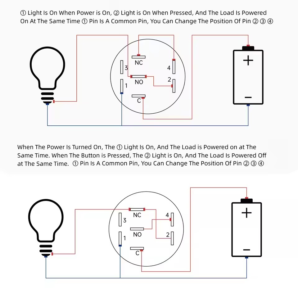

Hello everyone, I'm currently working with an rgb pushbutton (https://www.aliexpress.com/i/3256803495515155.html?gatewayAdapt=4itemAdapt#) that was given to me, and I need to make it so that when I push the button, it changes colors from blue to red.

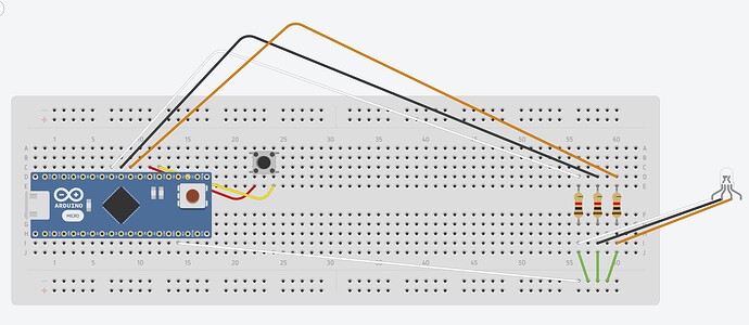

I am incredibly new to using Arduino, and I have no idea how to wire the pushbutton that I was given. Currently, I see 5 wires coming out of the pushbutton, one connected to each of the following, 1, 2, nc, no and c. Attached is my code and a diagram of how I have the breadboard currently wired.
  const int button = 2;
  const int r = 3;
  const int b = 4;
  const int g = 5;
    pinMode(button, INPUT);
    pinMode(r, OUTPUT);
    pinMode(b, OUTPUT);
    pinMode(g, OUTPUT);
    digitalWrite(b, HIGH); // set pushbutton to blue
    digitalWrite(r, LOW);
    digitalWrite(g, LOW);
    int reading = digitalRead(button); // get button state
    if (reading == 0){ // if button is pressed
      digitalWrite(b, LOW);
      digitalWrite(r, HIGH);
Any help is greatly appreciated, thank you.

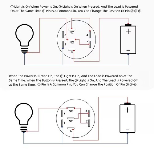

Drawing from AliEx for reference.
I think you hold a record in how new one can be... but now you've been here for 27 mins, so not so new anymore! :upside_down_face:
Connect one side of the button to GND, the other to D2 (no resistor) and change
to
pinMode(button, INPUT_PULLUP);
Also you need to add some delay, otherwise the code will just loop as fast as it can = you will see all three LEDs lit since the human eye cannot keep up with the rapid changes.
Edit: "loop as fast as it can" while you press the button.

btw, if you didn't know already: NC means normally closed, and NO normally open. Press the button will invert that state.

so just to clarify, for the button, one side should be GND with a resistor, and the other should just be a cable to digital2?
edit: I'm attaching a photo of my current breadboard as well as a diagram of the board, though I can't find the pushbutton on Tinkercad, so I just put in a button and an led light. The actual button and rbg light are just cables coming from the rbgpushbutton in the photo.
No. Read carefully:
The resistor's function is supplied internally by the microprocessor, that's what INPUT_PULLUP does; but now that means the pin reads HIGH normally and LOW when pressed.
a7

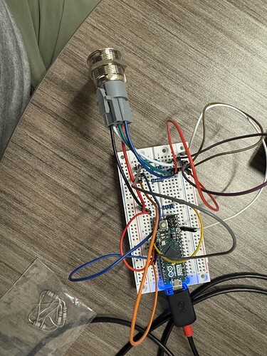

Thank you for the response, I changed the two pins to the button earlier to get rid of the resistor and used INPUT_PULLUP, but didn't say anything in the thread sorry. This is a photo of my current breadboard, along with my code.

If the wiring is unclear, I can send another photo, but it should be the same as the tinkercad diagram I sent out earlier. Also I have not tested the LED's by the method you suggested, again, this is my first Arduino project so I didn't even think to do something like that, I'll test it now. Thank you again for the response.
Can you verify all the LEDs and the button function? I see in your sketch you got Serial, so does Serial show High or Low when you use the button?
It will only print high, even when I press the button, or hold it down. And it only ever shows red, even when I plug the anodes directly into 5v. Do you think it's a problem with the button? Or something with my resistors, maybe? Thanks again for the help.
That's one possibility, but usually it's we humans that makes mistakes. Do you have a multimeter? I would test the button with that. Strip away as much as possible and test from the ground and up.
Btw, you've done good by using Serial.print, it's an excellent tool.
