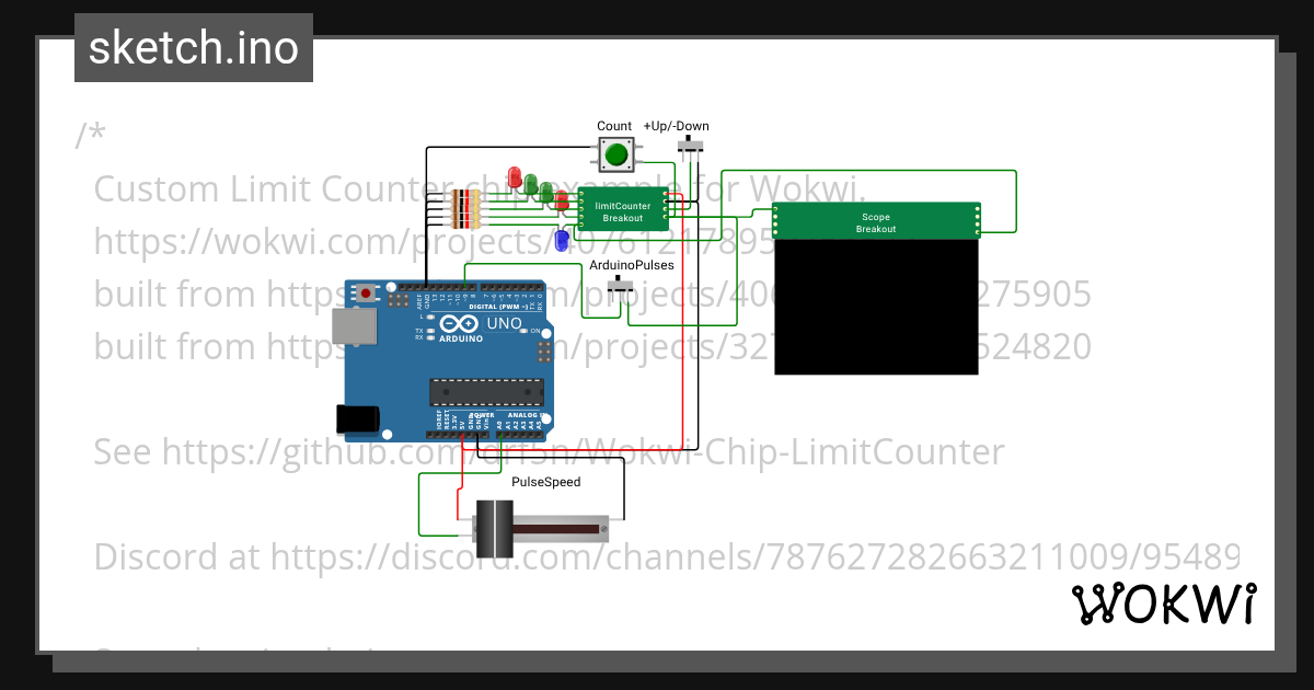

Up/Down counter limit switches
Here's a Wokwi custom chip with an up/down counter and upper/lower limit/threshold outputs:
  • Wokwi limitCounter -- up/down counter with NO/NC high/low limit outputs.

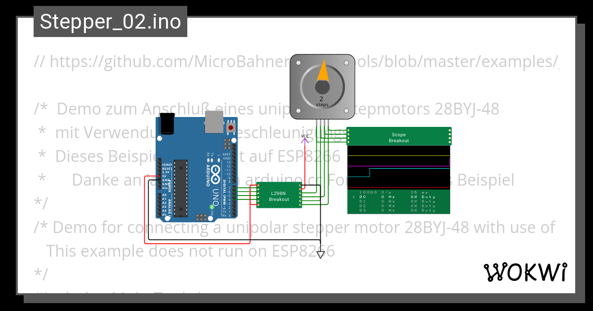

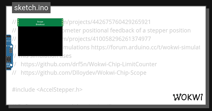

It isn't a custom chip, but I also learned that you can use the Wokwi stepper motor inputs or A4988 outputs as quadrature signals that work as an encoder:
Stepper quadrature output as encoder input
And another with an A4988 driver and clearer quadrature output/input signals.
(With that, you could read a couple of the motor's quadrature signals with an Arduino and with a function on the Arduino, simulate motor feedback.)

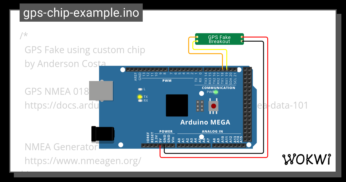

GPS
Luxometer BH1750

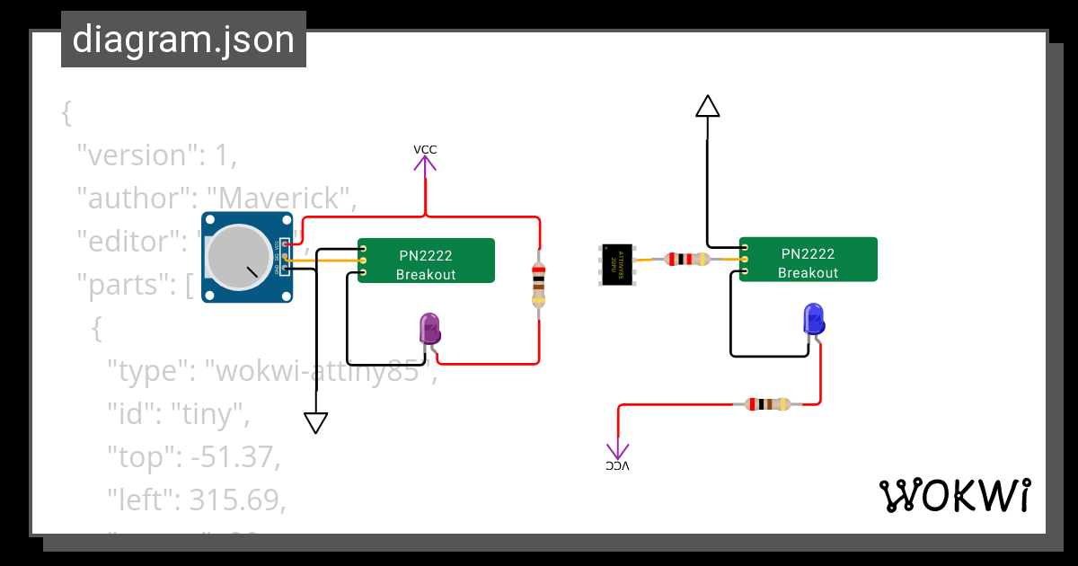

Wokwi PN2222 transistor custom chip:
Found on Discord

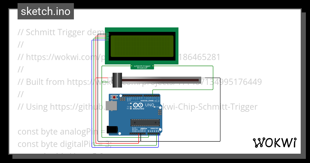

Schmitt Trigger custom chip
This demo has an attribute for threshold and hysteresis:
Nice.
Add an LED that follows the output state.
I am curious though, given wokwi's limited analog capability, where you see this being used.
I haven't played much with the analog sensors they do have, so.
a7
I added two LEDs, one upstream and one downstream of the Schmitt trigger, and also a digitalRead of the pot. I think I was playing with sensing an analog signal on a digital pin, and Wokwi wouldn't do it unaided. Arduino AVRs have schmitt triggers on their inputs, and if you do some switch debouncing with a cap, the hysteresis of the ST makes them pretty clean.

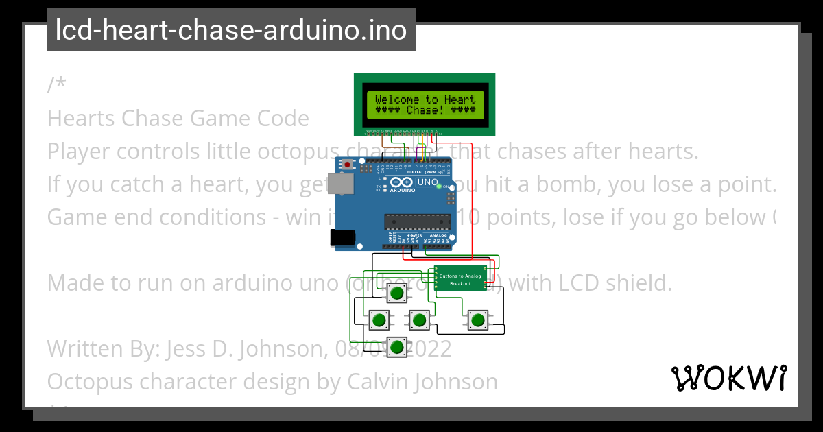

Resistor-ladder voltage divider as built into an 5-button LCD shield:

Here's the Up/Down counter limit switch packaged in github for use as a Wokwi custom chip dependency:
The chip could monitor the step/dir of a stepper motor and simulate positional feedback as limit switches or a potentiometer, such as in:
