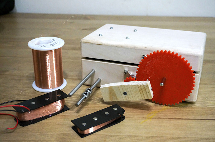

  • Sounds like an UNO would suffice.
  • Don’t overlook using a geared motor for this.
  • Suggest you look at using a modern stepper driver chip.
  • Always show us a good schematic of your proposed circuit.
    Show us good images of your ‘actual’ wiring.
    Give links to components.
Thanks. I know I said speed doesn't matter, but, the unipolar pictured in your image won't run over 15rpm. I was thinking 100-200rpm maybe. But I did just get that unipolar to run (when I finally lowered the speed to 15). Otherwise it just sat there and got hot, not turning.

Sorry, I just flashed on the image and it brought up what I just found out with trying to use the unipolar. I have that video saved off in my useful links, but haven't watched it within the last week. I have a couple of different stepper controller boards I just got to experiment with:
