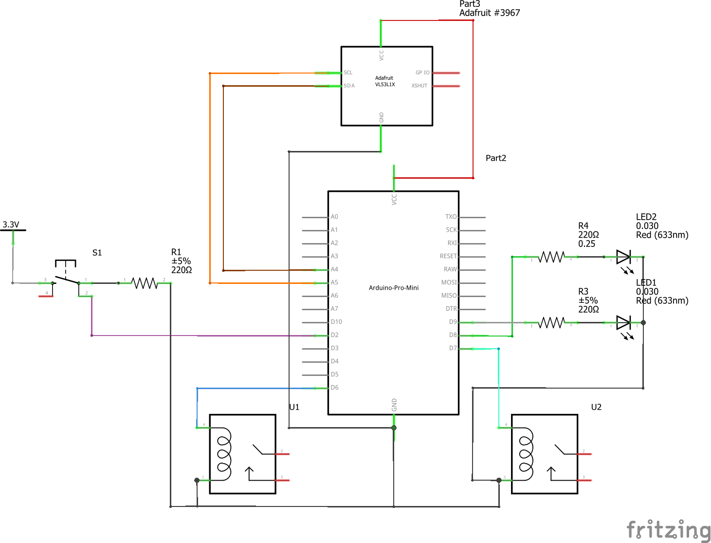

Is your button (pin 2) wired correctly?
Are your LEDs wired correctly?
Do you see any LED activity?
Do you see "CLOSE" or any distance? "Nothing" is not descriptive.
Put some Serial.print(); lines in doThisOnce(), refresh_time(), and complete()... to tell you where your program is running.
Show a drawing of your project.
the button already wired correctly and the arduino already run the program, LED also light up. But the sensor only measure distance once, not continuously during the whole 20s countdown.
Schematic attached below.
Remove the timer. Adjust the VL53L1X to your needs. Re-introduce the timer.
Four times through doThisOnce() is ten seconds... and you have no debounce on your button press.

You know what, it's already fixed by declaring
int16_t dist = sensor.readRangeContinuousMillimeters();
inside the measuring void
