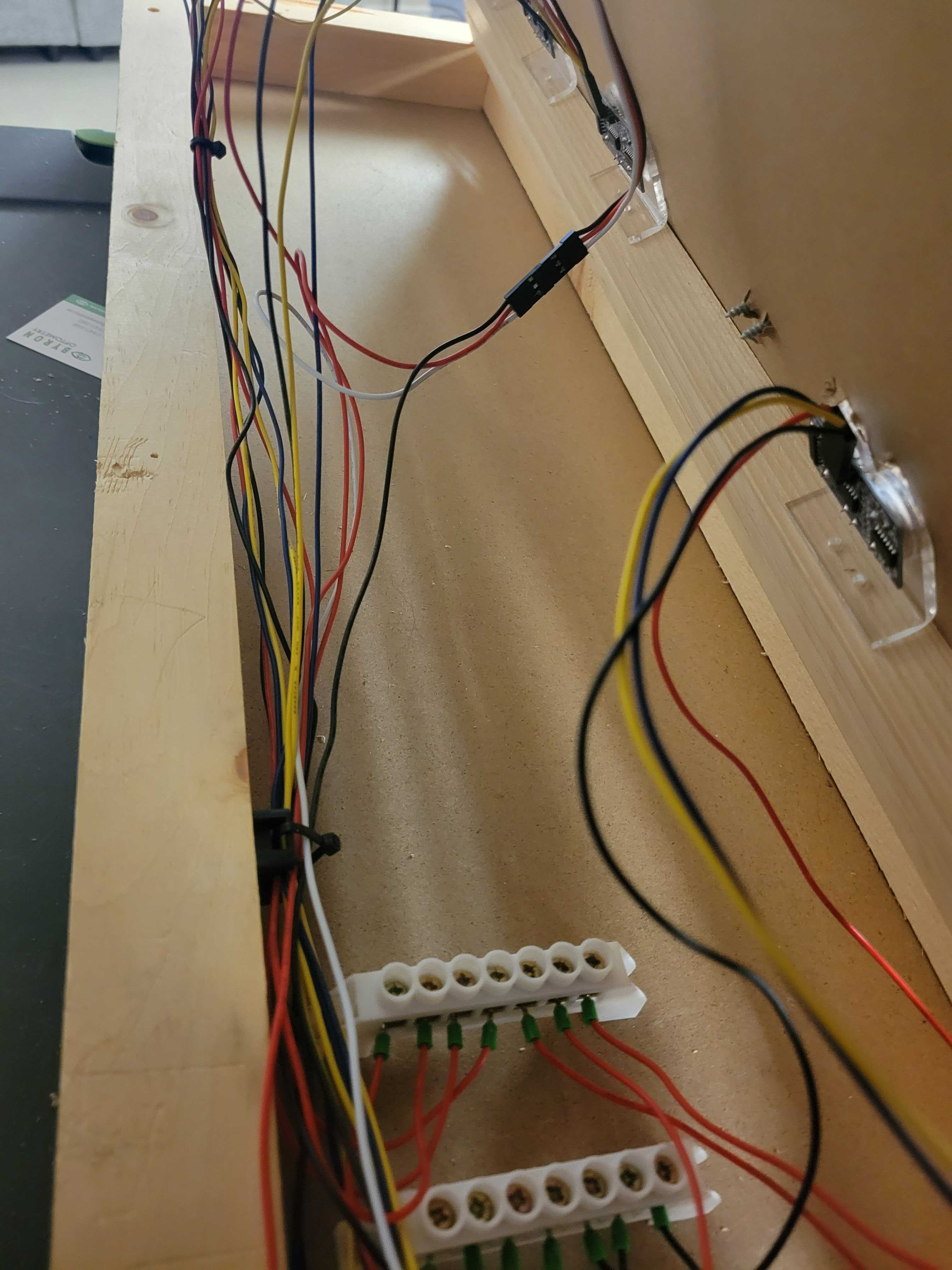

Works when connected to PC not on 9V battery
I have the following sketch, I am powering the servo with 4 AA batteries at present. It worked for a bit via the 9v battery but no longer works when powered by the battery. The board is controlling 6 ultrasonic sensors and the servo. As stated the servo is not powered by the board. If I plug in the USB port to my computer the servo will work fine but not when connected to the 9v barrel connection

post a picture of the circuit
Uploading: 20220609_134749.jpg...
sorry I meant a drawing where we can see all the pins, power etc
OK that will take some time is there a particular program you suggest for doing this in?
This is a close version of the circuit, I do not use bread boards however, the ground and vin for the sensors go to the white connectors seen above, I also do not have anything going into the VIN on the board from the AA battery pack it connects directly to the servo and ground on the board
and I do not have the 9v on there but it is a barrel connector that goes into the board
So you have a 6V battery pack going into Vin and 9V going into the barrel?
The 6V battery pack goes into the servo and 9V goes into the barrel currently nothing is plugged into the Vin
What’s the real version? ….
Do GND connect directly?
As far as I can see, there is something in Vin according to your drawing.
