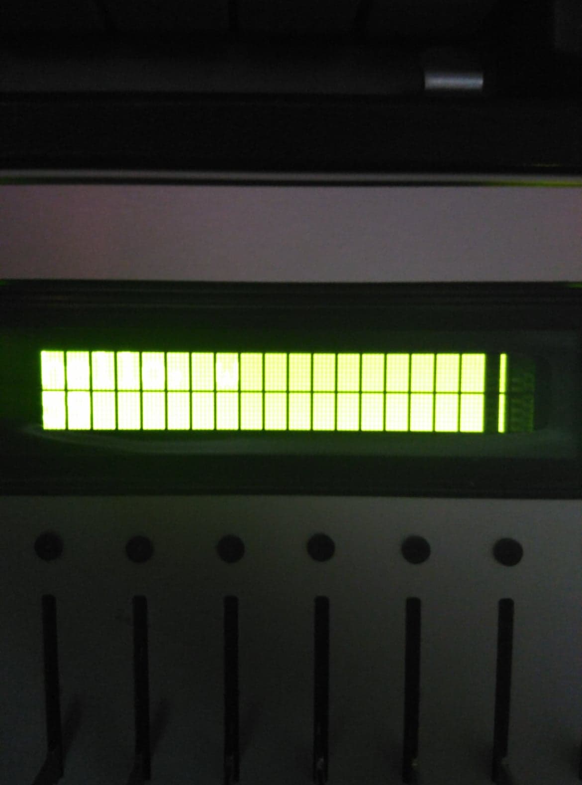

Hi, I just buy a Mida 20x2 LCD display and only the 8 first characters on each line are displayed.
Regarding the datasheet (http://www.farnell.com/datasheets/1934375.pdf) I would like to write a char at address 0x0A, how can I do that ?
Thanks

I use the LiquidCrystal Hello world exemple, just change lcd.begin(16,2) to lcd.begin(20,2). I also try with LiquidCrystalFast but it is the same. I use the 4 bits wiring.
I just want to write a char at the address that are referenced on the datasheet like 0x0A.
Your LCD is yellow on black. i.e. it must use a backlight. it is not much good in daylight.
If not initialised, you should see 20x1 boxes.
If initialised, you might see 20x2 boxes. Adjust the contrast to reveal the letters.
Install the hd44780 library.
Get regular text working properly.
Then use lcd.setCursor(9, 0) to draw the next letter at the 10th position on the first line.

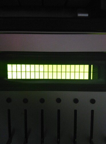

Here are pictures of the screen with high contrast and low, the program is the one below. The wiring is as in the program.

There are two boxes on the right that are dead I think...
Wait for Bill Perry to wake up. He will know.
It looks as if your display is faulty. Contact Farnell. They will replace it.
David.
Let Bill rest. There is a problem with the display, specifically the auxiliary controllers or the connections to them.
Don
I agree with Don, in that it appears to be an issue with the display.
(Don is the actual expert when it comes to hd44780 chip/chipsets)
What does seems odd to me is that the when the contrast adjustment is way off all the pixels can be driven, but when set properly only the pixels on the left half of the display are begin driven.
I would have thought the zebra connectors might have been an issue but I would think if that was an issue that the righ pixels would always be off.
Maybe Don could speak a bit more as to what might cause this symptom.

Thank you all for your help, I just call Farnell, they will send me a new one ![]()

I was wondering about that as well. My conclusion was that in any case it is still a hardware issue.
