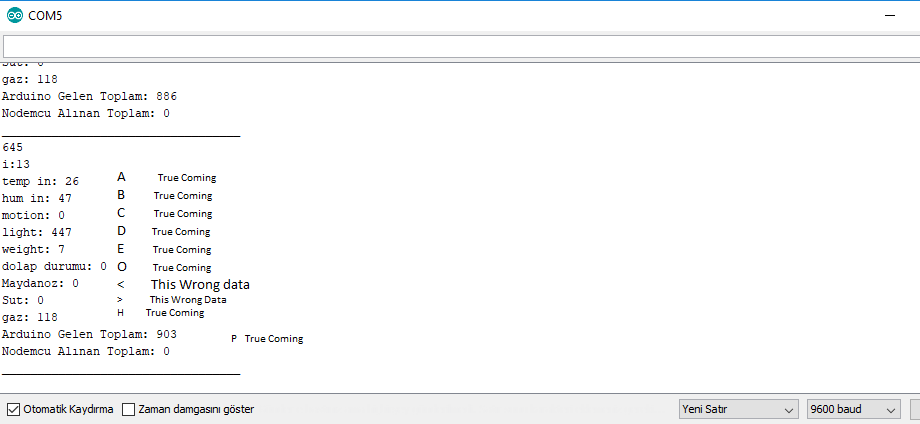

Hi , My problem is that ; In my serial communication between Arduino and nodemcu, 8 data are correct but nodemcu shows only 6 of them correctly.it is not a problem when I send two data alone.I sending serial port with arduino the following data is going
A25B30C0D4E255F255G100P681
But
Nodemcu is reading
A25B30C0D4E0F0G100P681
I mean nodemcu E and F incorrectly reads data
I used serial.parse and Serial.find command

Arduino Sending is Serial port this ;
Serial.println('A' + String((int)temp_in) + 'B' + String((int)humidity_in) + 'C' + String((int)motion) + 'D' + String((int)light) + 'E' + String((int)weight) + '<' + String(int(okunan_sut)) + '>' + String(int(okunan_maydanoz)) +'H' + String(int(sensorVoltage))+'O'+String(int(digitalRead(dolapkapak)))+ 'P'+String((int)CRC_hesaplanan));
Nodemcu taking
if (Serial.available() > 0)
    if (Serial.find('A')) temp_in        = Serial.parseInt();
    if (Serial.find('B')) humidity_in    = Serial.parseInt();
    if (Serial.find('C')) motion         = Serial.parseInt();
    if (Serial.find('D')) light          = Serial.parseInt();
    if (Serial.find('E')) weight         = Serial.parseInt();
    if (Serial.find('P')) CRC_recv       = Serial.parseInt();
    if (Serial.find('>')) okunan_sut     = Serial.parseInt();
    if (Serial.find('<')) okunan_maydanoz= Serial.parseInt();
    if (Serial.find('H')) gas            = Serial.parseInt();
    if (Serial.find('O')) dolapkapak     = Serial.parseInt();
But your sending order is different from your receiving order! How do you expect this to work?
Serial.find cannot search backwards. It can only search in forward direction. Your sender sends data in ABCDE<>HOP order. In receiver code you do this
Once you've called Serial.find('P'), you have skipped (and lost forever) all data that was stored between E and P. You skipped <>HO part. There's no way to return to that data afterwards. So the next Serial.find('H') will not find the H that you already skipped. It will grab for the H from the next data package (skipping everything else) or simply timeout.
If you want to use that Serial.find technique in your receiver, and your sender sends data in ABCDE<>HOP order, then you will have to do Serial.find in exactly this order. Any deviations from this order, and your Serial.find approach will start skipping values.
Also, why is your < and > tags mapped to different values? On the sending side < is okunan_sut. On the receiving side > is okunan_sut.
My friend only works when I install another piece of software with the other code when I add the error I said. like the picture in the plugin
I used '<' and '>' this tags but the others not working I mean just I try its and others char but do not working by the way.

I don't think there's a problem sending data and getting data because when I do a software separately I send the same data randomly, the nodemcu reads it correctly.
I mean, I don't know if this problem is caused by other codes, maybe it's due to the rfid door, but it works when I try with rfid.
Because when anything passes through the rfid gate, one of those values turns from zero to half, but it's still wrong.
I think the weight sensor breaks the job, because the communication takes 1 second. If the weight is added to the measurement, the communication is delayed and some of the memory is misleading.

I find it.This weight sensor "hx711" prevents the two data from going off.
When I cut off the power of "Hx711" everything went back to normal.
But when I give him his strength, it's the same.
