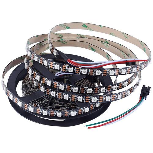

I bought a generic WS2812b ARGB strip with the intention to use it inside a computer, being driven by the motherboard. Looks like this one:
Tested it and it randomly flickers and there are random artifacts and color flashes. It becomes very noticeable when the strip is set to a single color, white for example.

I bought them locally, they are as generic as generic can be.
Here is a photo of the actually LEDs:
https://i.imgur.com/K67bXTD.jpeg
They are 4 pins leds 5050 packages with an IC built into the LED. Is there a way to know exactly what type they are?
Don't have any other addressable leds.

It's unlikely to be the strips. The odds are on your execution.
Please elaborate.
I connect a short strip of 10 LEDs to the motherboard header, using the shortest wire possible, I even tried ferrite beads and shielded wire for the data line, and it flickers badly. How is my execution an issue?
I will never know until you show me. But I'm tired of the passive responses, so I'm out. For example, no response from you at all, about the issue and question I made in reply #6.
