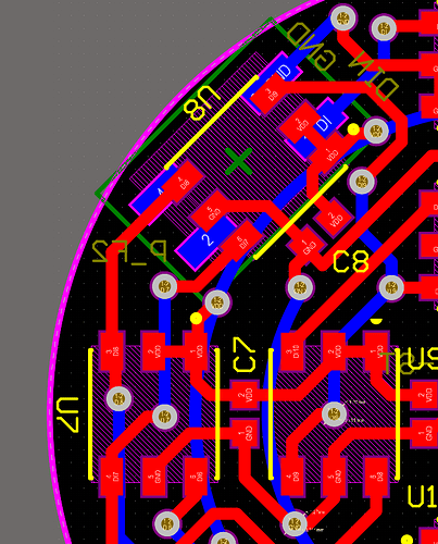

Hi all,
I made a small board with a bunch of WS2813s on it. It's working as intended apart from one of the chips not working. There are 12 on the board but I can't get number 9 to light.
I'm using an arduino mega 2560. Previously I had an adafruit ring with ws2812s and it was working fine. Once i've switched over to these boards, everything works as intended except for LED 9.
I'll attach the Schematic & PCB picture below.
I don't expect anyone to diagnose any connection issues on the board, i've triple checked that and i'm confident it's not the issue.
I've tried Adafruit and NeoPixelBus libraries and have the same issue on both, i then reduced my code down to lighting up a single LED and can light up every single LED by itself except 9.

I've verified the issue on 3 out of 5 boards I got made (Just haven't tested the other 2). Can anyone see any causes for issue here?
when you change pixel count to nine, does then tenth led light? Maybe pixel nine is just bad.
can you ohm out do on pixel 8 to pixel 9 di?
who made your boards? Can you post a picture of the actual boards... looks like a manufacturing issue baring all else. You could try manually adding a wire from pixel 8 do to pin 9 di....
your capture i don’t see a link connecting do8 to di9 but i can’t see the bottom of the board. Maybe you have an airwire.

No, 10th light does not light up.
Yes, do of pixel 8 is connected to di of pixel 9 verified using multimeter.
Boards were manufactured and assembled using JLCPCB.
I'll attach a picture of the board in altium showing top and bottom layer tracks.
Hmm... but if you switch to all 12 leds all of them work but ninth one?
Can you try switching though colors (not just white)?
It certainly seems like a bad pixel, but it would strange that it happened at the same time for all the boards.... and i would expect led10 to light.....
Are your grounds between the pcb, arduino, and psu connected with a moderately large gauge (like 18 awg)?
