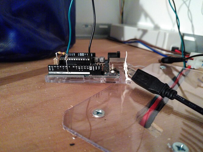

WS2813 LED strip glitches after +- 1 hour
12V measures 12.3V
Arduino measures 4.98V (from 12V supply)
The connectors you stick into the Arduino are unreliable. You should use male-header pins which are square in shape and fit much better.
That actually is more than the Arduino's regulator is rated for as an input. Though it seems functional, i would make sure programmatically that it isn't shutting down periodically due to overheating. Something simple that lights up the built in LED for 10 seconds when the sketch starts would probably do.
Always does. Just confirm with a multimeter that there are no shorts between Vcc & data terminals & GND anywhere but the 1st Bin & GND, and that the 5v rail on the strip is actually powered.
I get it from the fact that the OP is not able to set the power supply to exactly 5V but something higher. Common sense suggests that because of that you are better trying to set the power supply just under rather than just over.

From what would you actually imagine the Arduino needs "protecting"? :roll_eyes:
ATmega328 absolute maximum voltage is 6.0 V.
