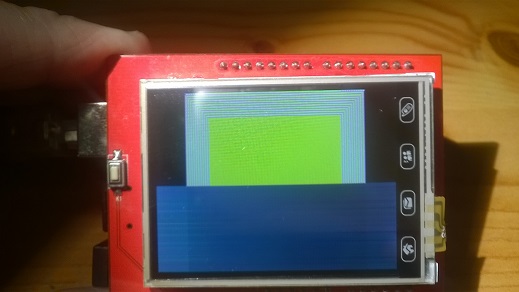

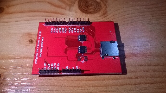

I have a problem with the display mcufriend. Half of the screen does not work. What do you think about?
Which library?
Which controller?
From your photo, it looks as if the Panel is broken.
David.
I applied, after a long search TFTLCD. The controller 4532, i got the mcufriend.com, but I had to redo, because I do not work.
