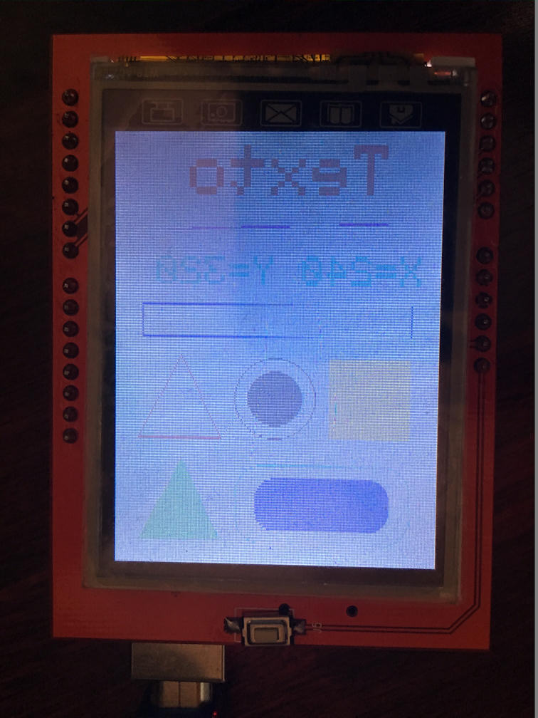

Dear David you were RIGHT!
I tried it again and it works, it seems the inner-ribbon was loose, by opening it to show it to you and closing it to check your library is worked (it turned on then off - on randomly), I glue it and pressed it with some small sponge and it is now constantly working. (showing things)
BUT there seems to be a problem with the touch screen, I run the TouchScreen_Calibr_kbv and only the 1/3 of the screen is working,
I include a result photo and what I see in serial window

Have you changed the NUMSAMPLES ?
The TouchScreen.h default value gives pretty unreliable results.
Typical values for LEFT and RT tend to be 130 and 950. i.e. about 800 difference.
Your values do not make much sense.
David.
I changes NUMSAMPLES to 3 , but when it runs, upper presses of the screen are not accepted so I have to press to the 1/3 bottom screen to continue....
so my cx >=600 always! maybe thats why values are so close.

So it looks as if your (YP, YM) = 78 is giving an unusual result.
I suggest that you get out your DMM and measure the resistance for yourself.
If as I suspect, your TouchScreen is outside the normal 300R - 600R range, you have got a bad Touch Panel. Probably due to your dismantling procedure.
These display shields are cheap. Buy another one.
Use your "damaged" shield for non-Touch projects.
David.

It is not mine TFT's ID but the result is more than nothing...
The result is on the attached picture. The screen is mirrored and flickered.
Big thanks in advance for any idea!
The CODE;

I found a sketch what was able to read my TFT.
This is the Result;
Read Registers on MCUFRIEND UNO shield
controllers either read as single 16-bit
e.g. the ID is at readReg(0)
or as a sequence of 8-bit values
in special locations (first is dummy)
reg(0x0000) 15 05 ID: ILI9320, ILI9325, ILI9335, ...
reg(0x0004) 00 00 00 00 Manufacturer ID
reg(0x0009) 00 00 00 00 00 Status Register
reg(0x000A) 00 00 Get Powsr Mode
reg(0x000C) 00 00 Get Pixel Format
reg(0x0061) 00 00 RDID1 HX8347-G
reg(0x0062) 00 00 RDID2 HX8347-G
reg(0x0063) 00 00 RDID3 HX8347-G
reg(0x0064) 00 00 RDID1 HX8347-A
reg(0x0065) 00 00 RDID2 HX8347-A
reg(0x0066) 00 00 RDID3 HX8347-A
reg(0x0067) 00 00 RDID Himax HX8347-A
reg(0x0070) 00 00 Panel Himax HX8347-A
reg(0x00A1) 00 00 00 00 00 RD_DDB SSD1963
reg(0x00B0) 00 00 RGB Interface Signal Control
reg(0x00B4) 00 00 Inversion Control
reg(0x00B6) 00 00 00 00 00 Display Control
reg(0x00B7) 00 00 Entry Mode Set
reg(0x00BF) 00 00 00 00 00 00 ILI9481, HX8357-B
reg(0x00C0) 00 00 00 00 00 00 00 00 00 Panel Control
reg(0x00C8) 00 00 00 00 00 00 00 00 00 00 00 00 00 GAMMA
reg(0x00CC) 00 00 Panel Control
reg(0x00D0) 00 00 00 Power Control
reg(0x00D2) 00 00 00 00 00 NVM Read
reg(0x00D3) 00 00 00 00 ILI9341, ILI9488
reg(0x00DA) 00 00 RDID1
reg(0x00DB) 00 00 RDID2
reg(0x00DC) 00 00 RDID3
reg(0x00E0) 00 00 00 00 00 00 00 00 00 00 00 00 00 00 00 00 GAMMA-P
reg(0x00E1) 00 00 00 00 00 00 00 00 00 00 00 00 00 00 00 00 GAMMA-N
reg(0x00EF) 00 00 00 00 00 00 ILI9327
reg(0x00F2) 00 00 00 00 00 00 00 00 00 00 00 00 Adjust Control 2
reg(0x00F6) 00 00 00 00 Interface Control
So I found in this result;
ILI9320, ILI9325, ILI9335, ILI9341, ILI9488, ILI9327, ILI9481
It looks to much to find the proper library for this...
Perhaps you should drink less Brandy at this hour in the morning!
You have a Renesas R61505 controller.
It is fairly similar to an ILI9325.
The R61505V and R61505W are supported by MCUFRIEND_kbv library.
If you wait for 60 seconds, I will add R61505 to MCUFRIEND_kbv library on GitHub.
David
Edit. GitHub has been updated. Download the ZIP. Install ZIP library from the Sketch Menu in the IDE.
I do not own R61505, R61505V or R61505W. I rely on Users to report any problems. This controller should do everything except for Band Scroll (it can only scroll the whole screen).
