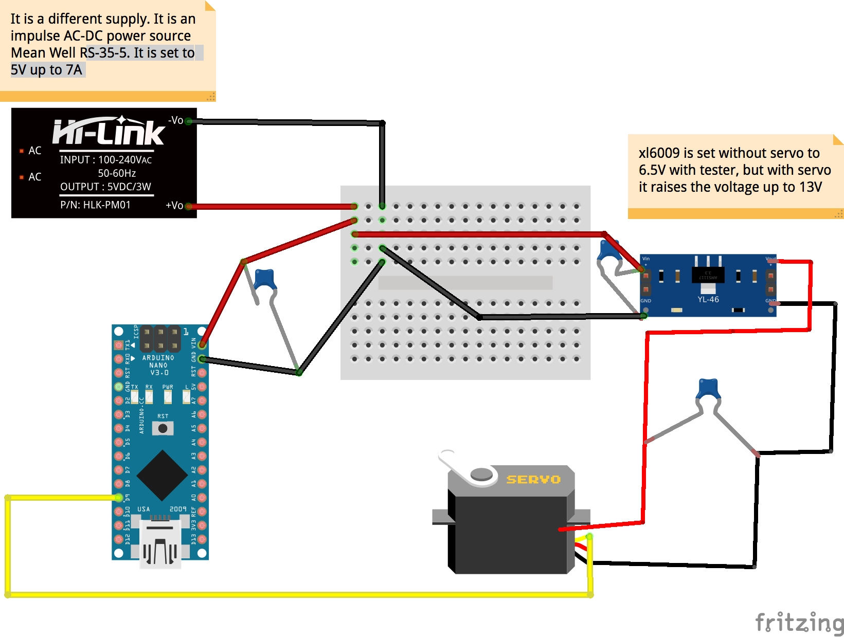

So how much decoupling have you got arround the servos and the boost regulator?
It is likely that the servo’s motor is generating interference that is being picked up by the regulator.

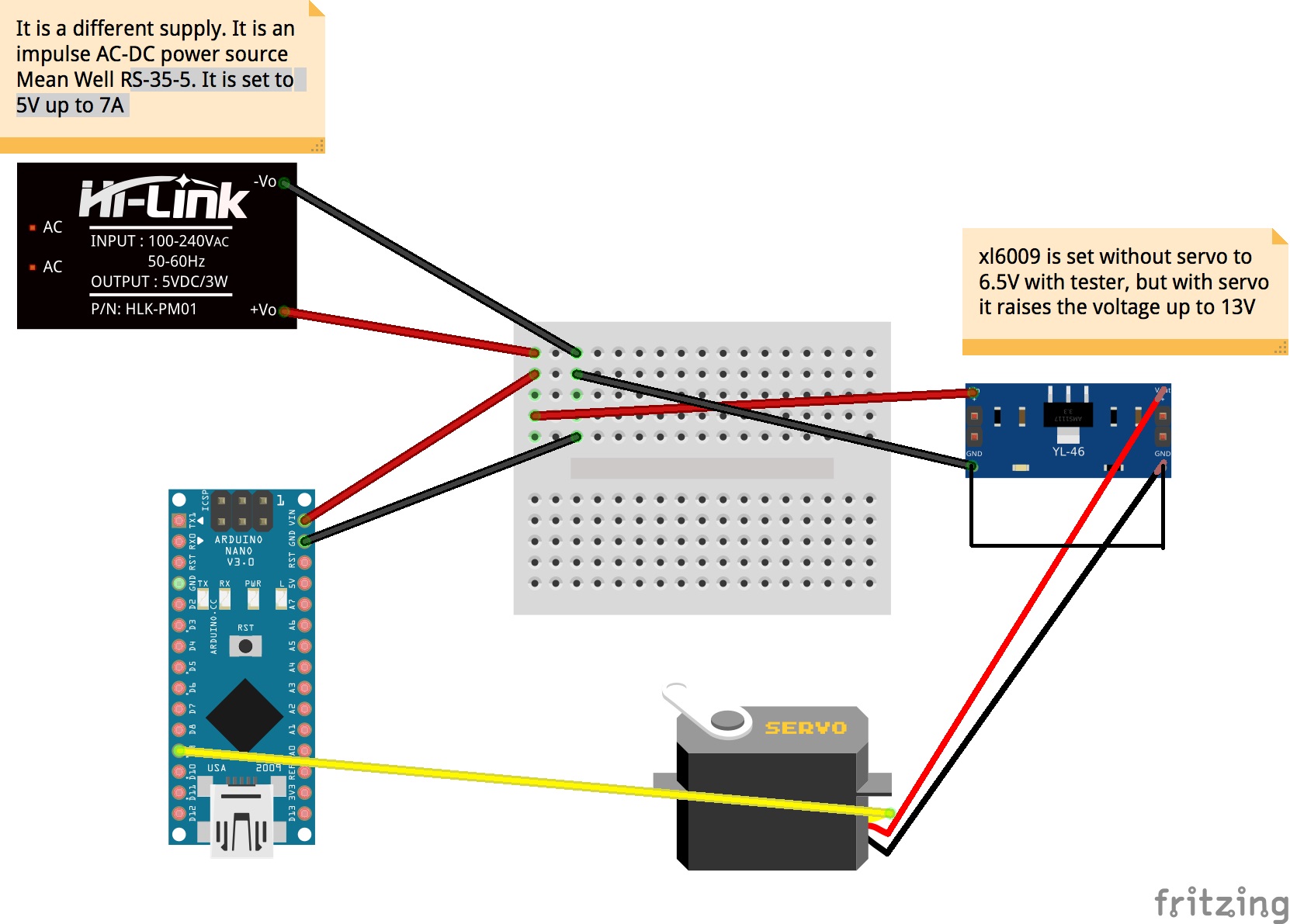

Can you post a schematic of what you have.
Here is something about supply decoupling De-coupling
Hi! Here is the scheme. I use Arduino Nano v3.0
So where is the decoupling?
I’ve read the article, but I don’t have an oscilograph and I don’t have a clue how to calculate it. (
You don’t calculate it you just do it.
OPs "circuit".
Connect the gnd input to gnd output on the XI6009 unit as in the diagram below.
I cannot find any reference that tells me if the output is isolated.
If the OP is using the Arduino gnd as reference, then this could be what is observed.
Tom.. :slight_smile:
I’ve checked the gnd on xl6009 and it is already connected. Otherwise I guess it couldn’t work.

But which capacitor should I use and where should I plug it?
Something like in this scheme?
Yes that cap placement will be fine.

As well as 0.1 uF ceramic capacitors I would also add a large 100uF or so on the output of your boost regulator.
The thing about decoupling to remember is that while you can under do it it is quite hard to over so it. Their is no “do this and it is fixed” you have to try what the circuit needs. It could be that you need the Pi filter with an inductor shown on the last diagram of that page I linked to. Try it first without but if it is still a problem then see if it helps. You can also put a large capacitor across the motor when you have the Pi circuit fitted.
