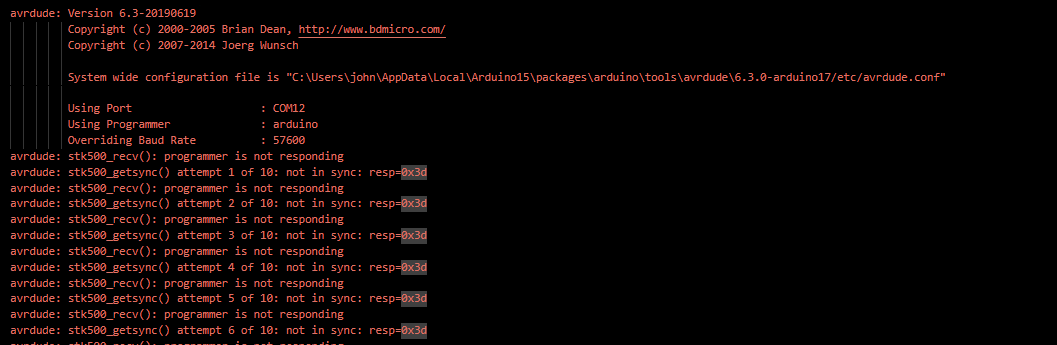

I realize this issue comes up periodically. I have a situation that statistically is impossible but yet is happening.
My test program is "blink without delay" with nothing but the programming cable connected to the Pro Mini boards.
I have a windows 11 pc with IDE 2.3.6, I've been working with a SAM21D and needed to switch back to a Pro Mini. The below test conditions have worked many many many times on the Win11 pc but with older IDE's (but wait, see below)
I connect one of my many Pro Mini's and start to download and received the Arduino equivalent of the Blue Screen to Death namely the "cannot sync..."
I am using a DSD FTDI programmer I'll call NEW. Has a genuine FTDI chip (based on the FTDI test program. My FTDI_old is a known chip clone.
OK so I try a different programmer, FTDI_old, same problem.... then:
Win11 - IDE 2.3.6 - FTDI_new - PROMini#1 - fail sync
Win11 - IDE 2.3.6 - FTDI_old - PROMini#1 - fail sync
Win11 - IDE 2.3.6 - FTDI_new - PROMini#2 - fail sync
Win11 - IDE 2.3.6 - FTDI_old - PROMini#2 - fail sync
Win11 - IDE 2.3.6 - FTDI_new - PROMini#3 (3V) - fail sync
Win11 - IDE 2.3.6 - FTDI_old - PROMini#3 (3V) - fail sync

I believe there are 3 choices in the Tools/Processor section, often it's the old bootloader choice
What was the exact procedure you followed to install it?
I ask because I see from the screenshot you shared that the upload baud rate was 57600. The most simple way to install Optiboot on an ATmega328P@16 MHz Pro Mini would be to select Tools > Board > Arduino AVR Boards > Arduino Uno from the Arduino IDE menus and then performing a "Burn Bootloader" operation. After that, you would need to use that same "Arduino Uno" board selection when using the Pro Mini, since the bootloader binary is compiled for an upload baud rate of 115200.
It is possible to install an Optiboot bootloader compiled for 57600 baud, as is easy to do using MiniCore, but that isn't the default for 16 MHz boards even when using MiniCore so even with MiniCore it is something you would have needed to chose manually.

I soldered up a fresh out of the package Pro Mini. It programmed just fine.
As unlikely as I thought it was, I had a few bad boards. And the optoboot one I don't recall any special programming steps.
