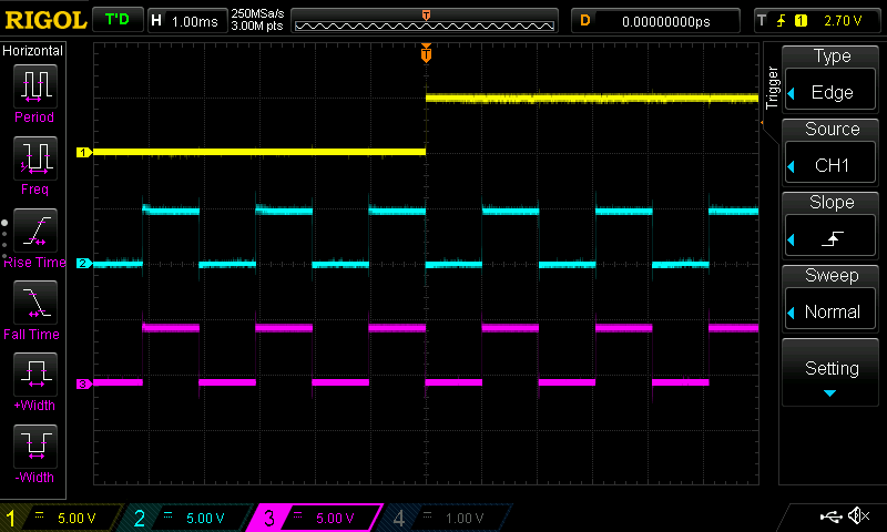

OK! I deem this "Solved". Here is my simple test program. Note that references to pin, port, and ddr access the GPIO registers directly -- I don't use the Arduino functions.

Using the (commented out) sei/cli, which doesn't work for the 4809, I see (top to bottom, running the time-consuming code, toggle on timer interrupt, toggle on another timer interrupt:
After commenting out sei/cli and adding isrIrqOn, the toggling continues during the time consuming code, and doesn't skip a beat as can be seen in this closeup:
