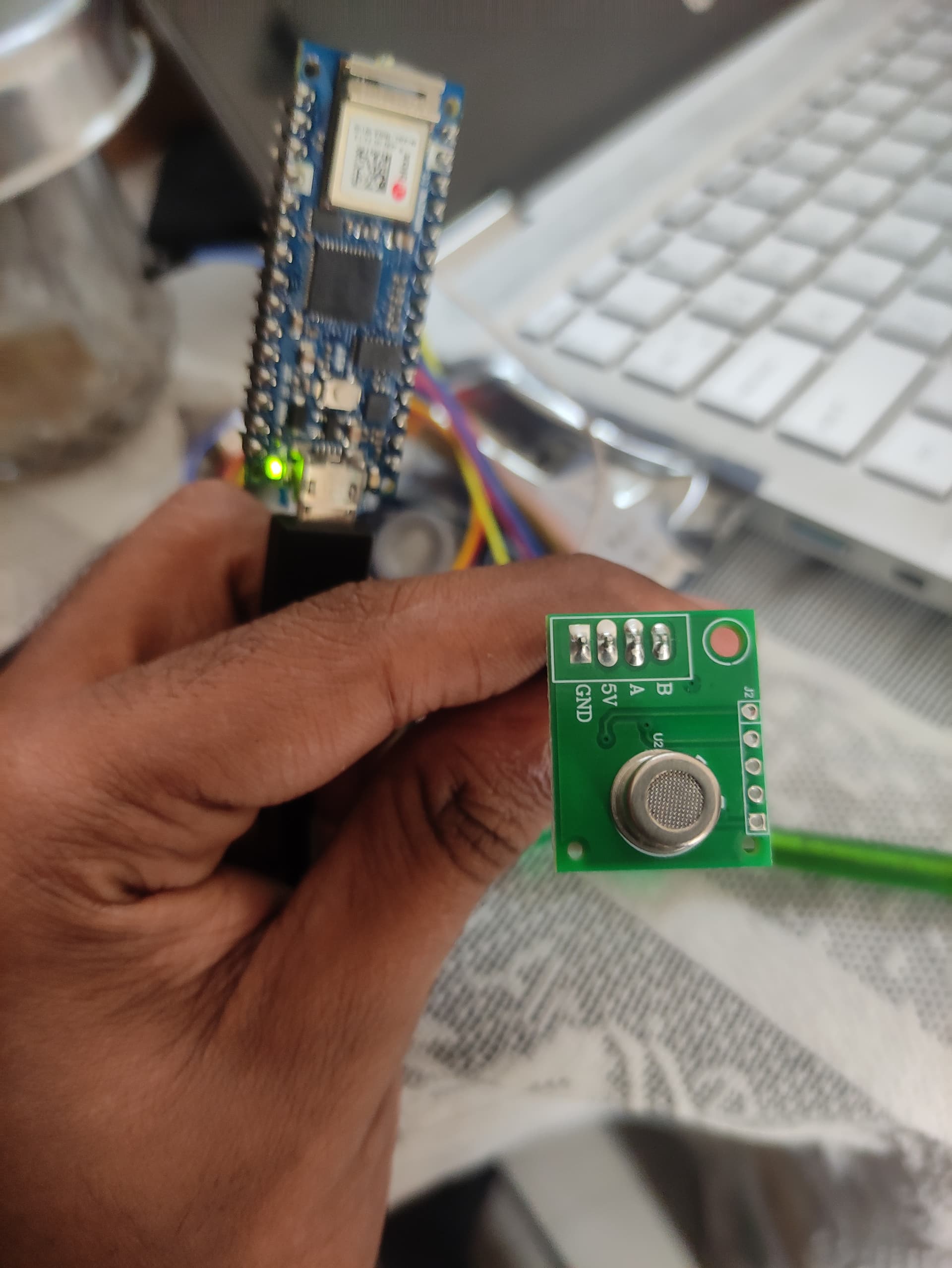

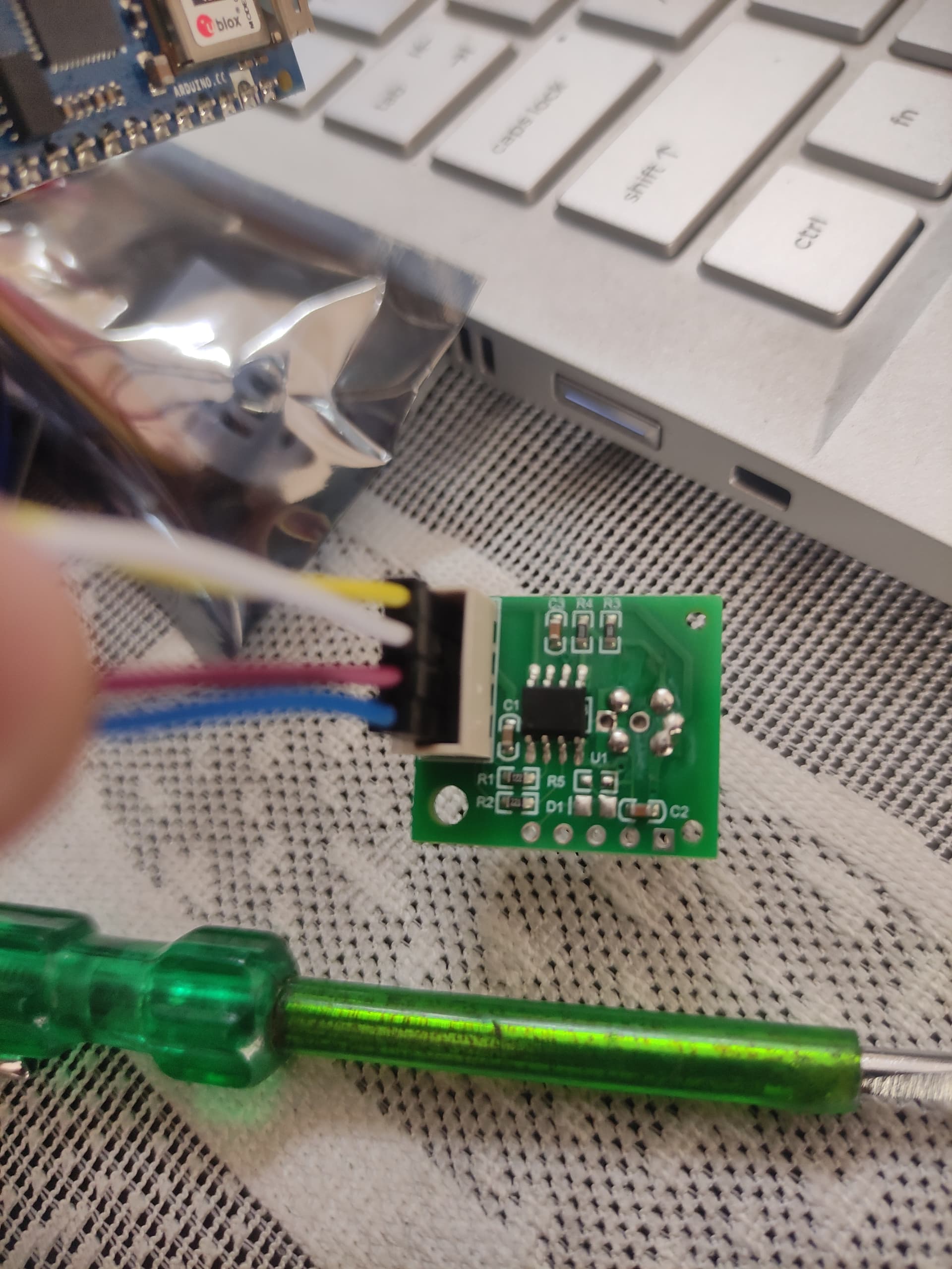

I have no idea where to connect the A and B Pins on the MP503 sensor. Can someone please help me with this. Also I'm using an arduino nano 33 iot board.
Datasheet: https://robu.in/wp-content/uploads/2021/03/Winsen-Air-Quality-Detection-Module.pdf

The MP503 is a resistive sensor, its value changes depending on the gases (and quantities thereof) detected (see datasheet).
The ZP07-MP503 module adds a comparator that switches outputs A and B based on 4 preset thresholds.
Pollution class    A output    B output    Air quality
        0            LOW         LOW         Clear
        1            LOW         HIGH        Slight pollution
        2            HIGH        LOW         Middle pollution
        3            HIGH        HIGH        Heavy pollution
Then you must read it with 2 digital inputs.
Remember that you must let the sensor preheat for at least 3 minutes (from power on) before taking readings.

Thank you, I'll try this out. I saw this datasheet but the one from the site from where I ordered the sensor had a different datasheet so I thought that the sensors might be different.
I just tried it out and It does work. Thank you very much for the help, really appreciate you spending your valuable time. Hope you have a great day :slight_smile:
