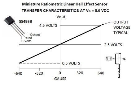

As far as I know, there are only two possibilities: hall or magnetometer.
Some hall sensors are switches (on or off), but some hall sensors have a linear analog output according to the magnetic field strength. They are called ratiometric hall sensors. You can buy them in different sensitivities. Connect it to the Arduino and you have a Gaussmeter :stuck_out_tongue:
A magnetometer measures the earth magnetism. They will measure a strong magnet a few meters away. But because they are so sensitive, they easily clip to the maximum with a strong magnet.

I would like the sensor to produce a voltage proportional to the distance (i.e. not a switch sensor).
It is very difficult to get a distance measurement from a magnetic field strength measurement, unless you have a setup where the relative orientation of the magnet and sensor is fixed and only the distance changes. Furthermore, the field strength drops off in a highly nonlinear fashion as the distance changes, so the entire setup would need to be very carefully calibrated.

Actually, the only question I have left is which would be the right hall sensor to get that will have an appropriate sensitivity and range to work with about a 2 foot distance of a speakers magnetic field. I've read the specs on many of them, but they don't seem to tell me the information I want. For example, the pdf:
Am I right in understanding from reading the specs on theSS49E sensor:
0 Gauss = 2.5 Voltage output,
Output voltage increases by 1.4V per Gauss
therefore giving me a range of 1.78 Gauss?
But then it says underneath that the magnetic range is +/-650Gauss
...I'm so confused...

It detects possitive and negative Gauss. So the output is normally in the middle at 2.5V.
The sensitivity is 1.4 mV/Gauss, that is 1.4 milliVolt per Gauss.
