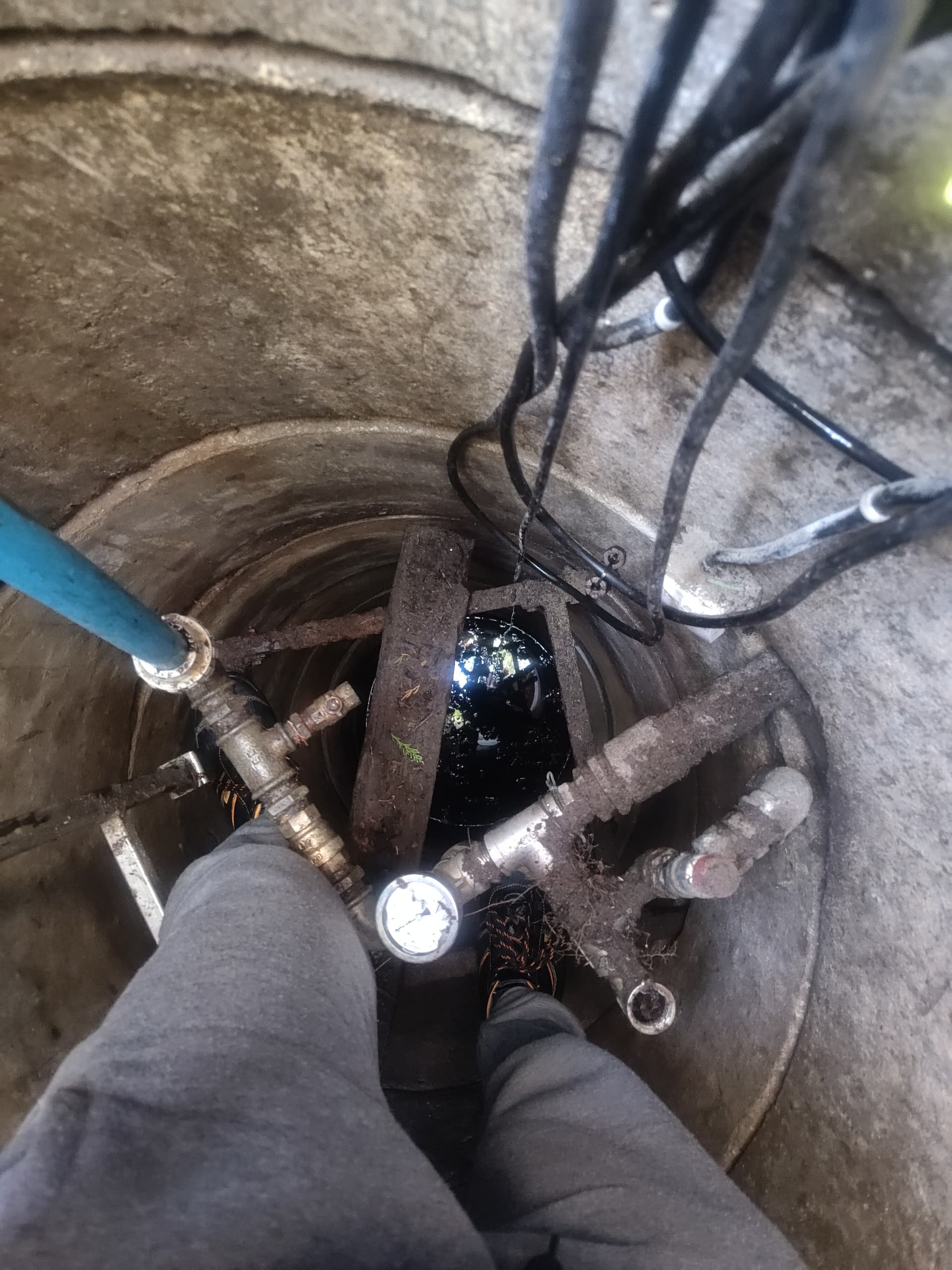

The sensor I'm using needs to be submerged, as it measures the pressure to which it is exposed.
I have seen other water level sensors that measure distance and they are not to be submerged, but placed at the top of the tank. The reason I haven't chosen one of those is that I have hoses and cables going down for the pump and I was afraid they would interfere with line of sight of the distance sensor. So I opted for the submergible type. They apparently also have a RS485 version. Can't say how durable they are, but mine looks pretty sturdy at first glance.
