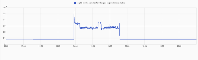

Unfortunately the measured voltage looks like this:

The distance from the well to the ESP32 in my basement is about 30 meters. When I connect the sensor with a 30 meter cable I get some small 0,1V spikes. When I connect via 10m, the spikes are bigger - around 0,3V.
I'm not sure where the issue lies and how to narrow it down. Could be faulty sensor, cable length, too low sensor voltage, incorrect esp32 connection, not really sure.
Does my connection and the components I used make sense? Would really appreciate some help, thanks!

Thanks for the hints, I was also thinking about removing the voltage divider, since the water will never be that high. The flatline is what's reported if there's nothing connected, I guess it should be zero, instead of 0,1v.
One thing I don't understand is why are there such spikes, instead of a constant line. I understand this isn't normal for an analogue sensor, right?

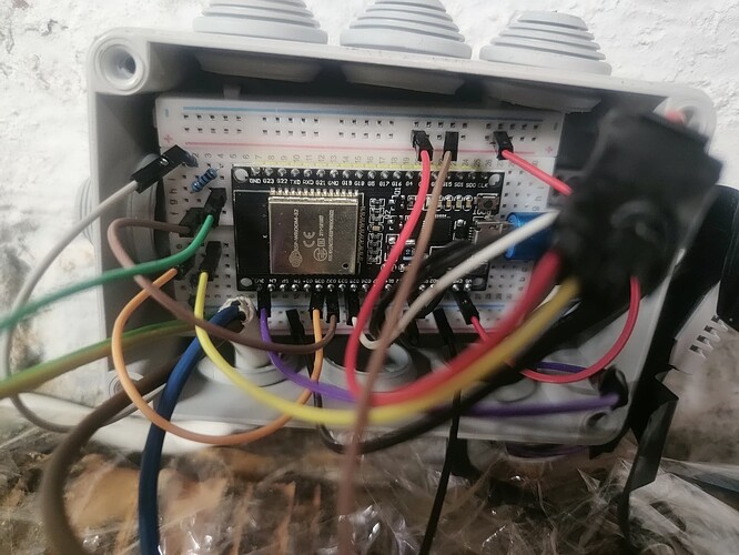

Is it possible to make an improved diagram, with all wires? I suspect there's more clues in a complete diagram. And the voltage divider, is it sensor -> 20 k - ESP32 - 10 k - GND or the opposite?

there are more wires, because there's also a water flow sensor and temperature sensor connected, but in theory they are unrelated :slight_smile: I can do some more testing with a bare esp32. But I previously had a different sensor connected to the same voltage divider and the diagram back the looked much better:
And I checked with a multimeter that the voltage was around 0,5V and behind the voltage divider ESP32 reported around 0,3V. 20kOhm is first as in the digram.

Yeah, sorry typo, I meant 0,3V as in the screenshot I pasted.

It looks much better now, and that initial spike is probably just from initializing, you could add a certain delay after the initial peak, and after that average the readings.
About the sensor itself and the way it measure, I'm just throwing in the possibility that it could be sensible to induced pressure waves in the water like sound, hence spikes in the readings.

Is there a common ground between the sensor and the ESP?
and if you do then it's another problem you can debug.
There isn't. Should there be one? Should I connect gnd of esp32 to V- on my power adapter?

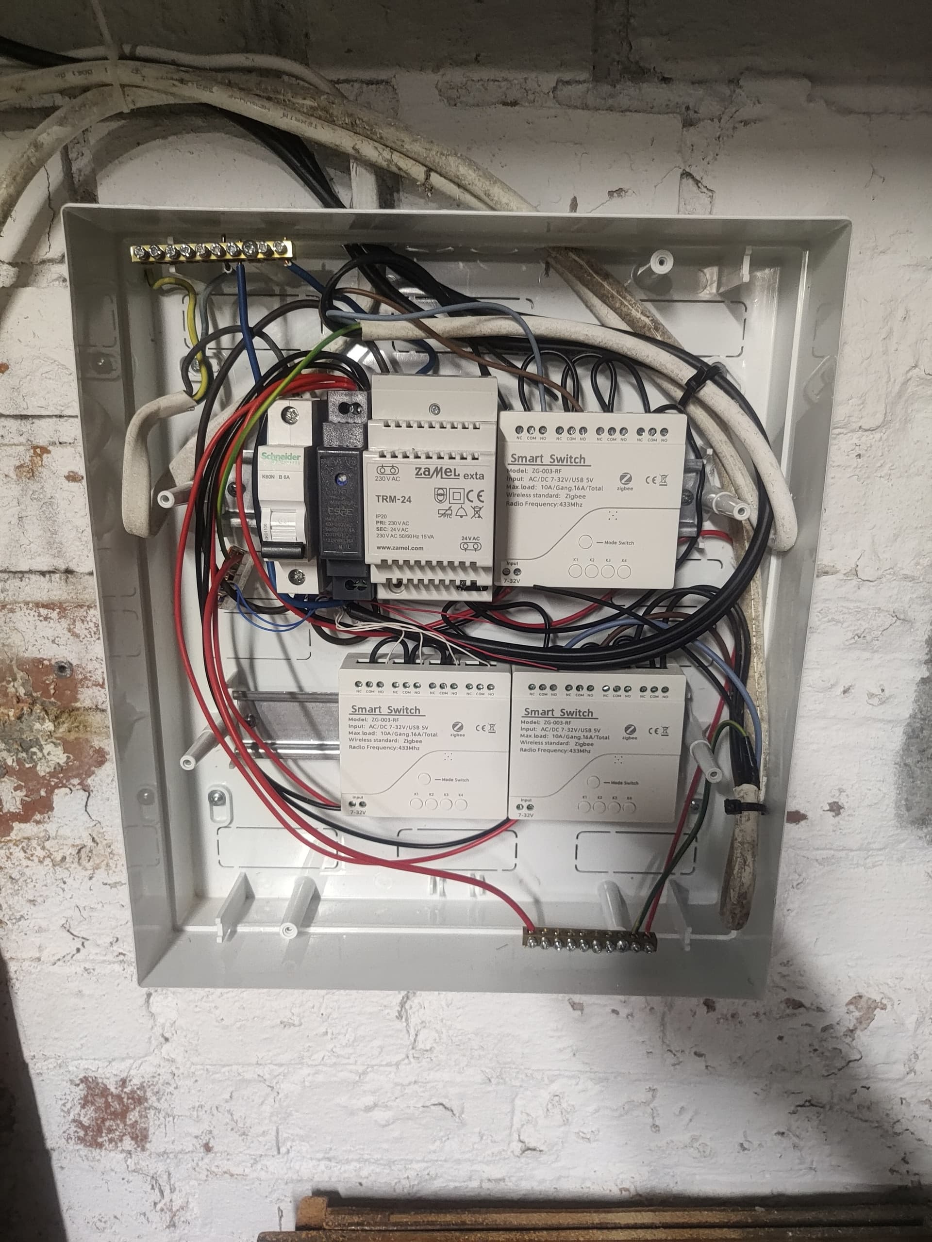

The 12V adapter is currently in my zigbee irrigation controller cabinet that I built
The ESP32 is in a separate box, but I guess I could move/connect the two. ESP32 is separate because it's close to a flow meter on a pipe and initially I had a different pressure sensor that was 5V and I powered it directly with ESP32 without any power adapters. A shop recommended it to me, but I later read it's not submersible.

Connect the ground of ESP32, ground of sensor and power supply negative together.
