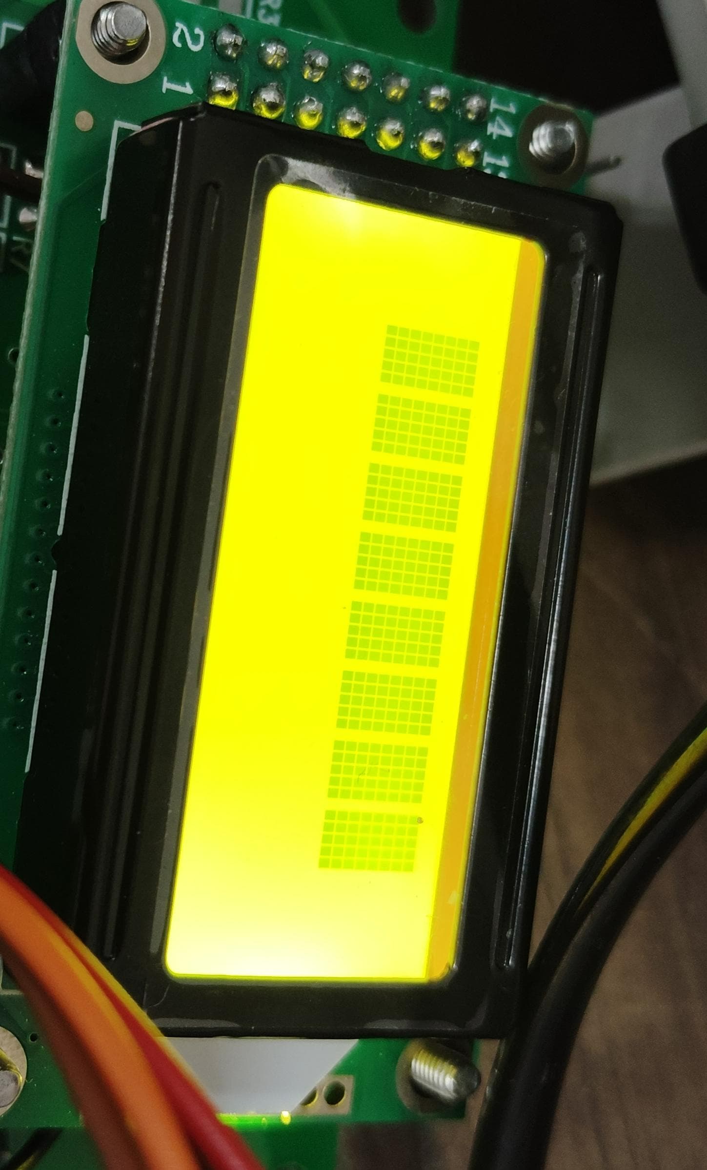

The LCD powers on and displays one solid lines (black boxes), but no characters are shown. Even after sending correct initialization commands (e.g., 0x28, 0x0C, 0x01), the display remains unchanged. The Display OFF command (0x08) has no effect either.
Observed Symptoms:
  • Backlight and contrast are OK.
  • LCD shows 1 solid lines (default uninitialized state).
  • No change after command execution.
  • Verified working pin connections and logic levels.

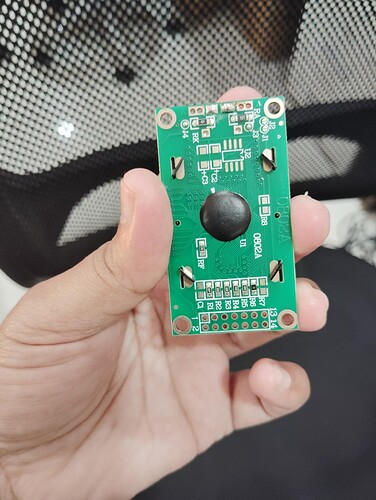

please suggest some solutions
![image|690x393](upload://2islNhYipjxRO75xyzCpplwzg58.png)
I moved your topic to an appropriate forum category @komalpatil.
In the future, when creating a topic please take some time to pick the forum category that best suits the subject of your topic. There is an "About the _____ category" topic at the top of each category that explains its purpose.
This is an important part of responsible forum usage, as explained in the "How to get the best out of this forum" guide. The guide contains a lot of other useful information. Please read it.
This is my LCD schematic pin mapping
