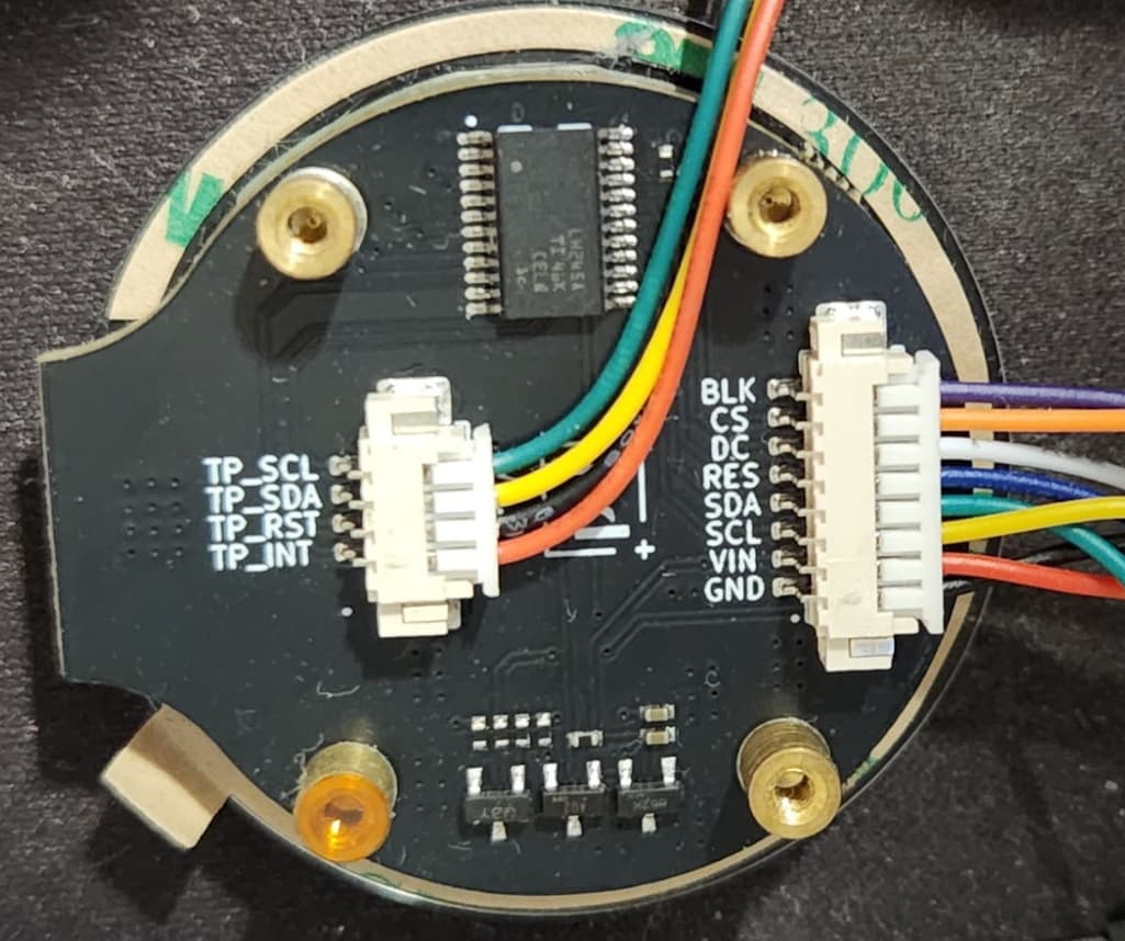

That's how the back side with all the connectors looks like:
Currently the wiring I used are as follows:
// Display connection
// BLK --> left unconnected
// CS (display_1) --> 15
// CS (display_2) --> 5
// DC --> 2
// RES --> 4
// SDA --> 23
// SCL --> 18
// VIN --> 3.3V
// GND --> GND
//Touch connections
// TP_SCL --> 22 (I2C-SCL)
// TP_SDA --> 21 (I2C_SDA)
// TP_RST --> 4
// TP_INT --> RX (GPIO 03)
The TFT part of the display works well, both displays are working while connected to the same ESP32 unit, where I can control each separately.

The subdirectory is where the IDE installation places the required files. Verify (or re-do) your IDE installation.
A few things I've managed to figure out over the last few days:
  1. pgmspace.h, is part of the AVR family board which includes UNO, NANO, MEGA etc.. this family of boards DOESN'T include the ESP32, and that is why I was getting this error. trying to compile this sketch after defining UNO as a board, works well.
  2. I couldn't find any way to activate the touch feature on this screen using an ESP32. Sure it is possible, but I just couldn't find any tutorial I could follow.
  3. I did manage to change an AVR type sketch to only operate the touch feature on this screen, this means that I can connect the display to an ESP32 (for the fast processing) and the touch to a Nano and then I need them two to communicate with each other - ugly solution, but better than nothing.
  4. Attached is the sketch I modified, it still has one annoying bug that I can't solve, which is that it usually takes two clicks in order to get the correct X,Y position.
  5. To connect the touch feature, you only need 6 wires:
    GND --> GND
    VIN --> 3.3V
    TP_RST_PIN --> 4
    TP_INT_PIN --> 3
    TP_SDA --> SDA
    TP_SCL --> SCL
Since I can't upload more than 5 files, the rest of the sketch is in the next post. all 6 files are required.
