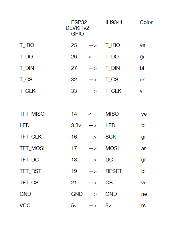

The electrical connection is as follows:
ESP32_pin_ILI.pdf (16,1 KB)
The image is identical to that of “6v6gt”.

I wrote this PDF to simplify the connections, in fact I also added color to the various wires used.

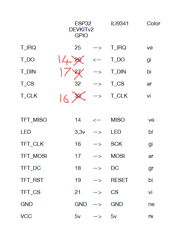

I think I see a problem already. The SPI bus is shared. That is you must connect the following display pins together:
T_CLK( display pin 10) and SCK (display pin 7)
T_DIN( display pin 12) and SDI(MOSI) (display pin 6)
T_DO( display pin 13) and SDO(MISO) (display pin 9)
The CS ( chip select pins ) are NOT shared. These are used to select the SPI peripheral which the SPI bus is currently talking to. That is T_CS and TFT_CS must use different pins (as you correctly have).
This is your current connection diagram:
It should look more like this as fas as I can see:

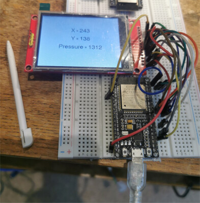

serial monitor output
X = 301 | Y = 43 | Pressure = 403
X = 242 | Y = 25 | Pressure = 674
X = 67 | Y = 39 | Pressure = 977
X = 212 | Y = 59 | Pressure = 683
X = 76 | Y = 36 | Pressure = 1782
X = 64 | Y = 56 | Pressure = 1814
X = 44 | Y = 83 | Pressure = 1846
X = 34 | Y = 114 | Pressure = 2026
X = 45 | Y = 151 | Pressure = 2083
X = 48 | Y = 178 | Pressure = 2119
X = 74 | Y = 207 | Pressure = 2088
X = 136 | Y = 206 | Pressure = 1556
X = 191 | Y = 205 | Pressure = 1935
X = 227 | Y = 211 | Pressure = 1782
X = 279 | Y = 225 | Pressure = 1673
X = 301 | Y = 218 | Pressure = 1632
X = 302 | Y = 205 | Pressure = 1540
X = 303 | Y = 188 | Pressure = 1511
X = 307 | Y = 169 | Pressure = 1435
X = 272 | Y = 148 | Pressure = 1531
X = 203 | Y = 131 | Pressure = 1583
X = 165 | Y = 131 | Pressure = 1872
X = 136 | Y = 114 | Pressure = 2017
X = 111 | Y = 104 | Pressure = 2013
X = 106 | Y = 85 | Pressure = 2002
X = 154 | Y = 114 | Pressure = 1977
X = 199 | Y = 136 | Pressure = 1853
X = 231 | Y = 173 | Pressure = 1727
X = 268 | Y = 155 | Pressure = 1655
X = 290 | Y = 153 | Pressure = 1483
as the pen is moved around the panel the display values are updated

Installed on the ESP32 it works, I see on the serial monitor the 3 values when I press with the coop,,, but I don't see on the display the writings with the values as seen in the picture attached in post# 13.
I figured out how the pins are connected.
I checked the connections and they are correct.
Did I maybe forget some verification?
To what ESP32 pin is the screen's CS pin connected ?
Your code used TFT_CS = 21. Horace's uses TFT_CS = 15.
I downloaded and used the sketch from “Horace”.
The TFT_Cs pin is 15.
Should the TFT_MISO pin be connected with the XPT2046_MISO ? (19)
Should the TFT_MOSI pin be connected with the XPT2046_MOSI ? (23)
Should the TFT_CLK pin be connected with the XPT2046_CLK ? (18)
I have not connected them together, should I do so ?
Yes.
You've said the touch screen works so the above three SPI bus pins are clearly correct.
That means, for example that the same ESP32 pin (19) must be connected to both XPT2046_MISO (marked TDO on the display module)
and TFT_MISO ( marked SDO(MISO) on the display module).
That is just as implied here:
