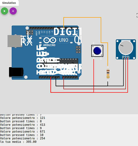

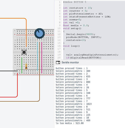

When the button is pressed shortly (press it less than 100ms), then it works.
What is the problem ?
This is a Tinkercad screendump:
And this is a Wokwi screendump:
Your Wokwi project is this link:
No account required. Logging in is only required to store a project. Press the start-button in the middle-upper of the screen.
Wokwi is still in development. In my opinion it has already passed Tinkercad, because a library can be added as local files. Here is an example with the BigNumber library that I added as local files to the project.

First you need to do a sample WHEN THE BUTTON IS PRESSED not WHILE THE BUTTON IS PRESSED
There is a difference, you want to press the button and sample ONCE, then press again and sample AGAIN, until you have 10 readings to calculate the average.
